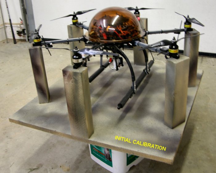

Buzzed
Here's a simple jig I made out of scrap lumber. Once the MK is set on the uprights it will quickly tell you if all support arms are on the same plane and square.
