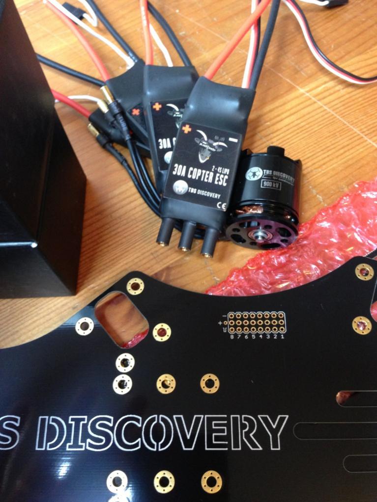

Torxpower 3536 motors, maytech 30amp ESCs and Wookong fc. I actually had/have a bit of a problem with the Wookong failsafe in that it doesn't want to come home, it just goes up and hovers like it does the first bit, then just stays there. I've updated the firmware since last night though, had the beta version on before, so need to test that again. I might have to move the GPS higher, it's only 3 cm above the FC.
