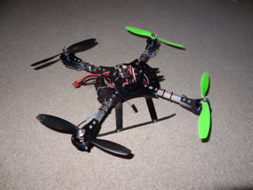

Hi Just built up a CC quad using .
500 Size Carbon Frame with Alloy arms. Cut down to 400mm Prop to Prop
Weight of frame at 500mm is 280g so very light.
http://www.quadcopters.co.uk/?PageID=ShowItem&Item=CA500&Desc=500%20Size%20Carbon%20And%20Aluminium%20Folding%20Frame
Keda 20-50s Motors
8" Gaui props 2 Green on the front.
Escs - 10a Hobbywing Pentium
Lipo 1500mah 3s 35c
Weight =507g without lipo.
Performance is awesome , Im Really loving this board .

Loks good Geoff.. them motors and esc' working ok then?
How easy was the CC board to set up? Did you do it on a PC or Mac?

The Board was very easy to set up , All done on my Mac .
Flies great with this motor and esc combo .
Made some adjustments and got it much more responsive , still tweaking it though :)

A few tips , load correct firmware lol ,, Im supposed to be a veteran and being excited with the new board and using Spektrum gear I selected spektrum firmware so this meant the receiver being PWM was not recognised. It is for Spektrum satellite :) Silly me ..
So load correct firmware ... 2nd the stock settings are very tame but this is a awesome board , so turn up angle limits a bit at a time and inner loop to get it how you like it , I havent gone too far with settings , but once Angle limits tweaked and turned up inner loop I got it pretty much how I like it .
The GCS is very easy to use and well laid out and it is no suprise this board is out of stock everywhere.
