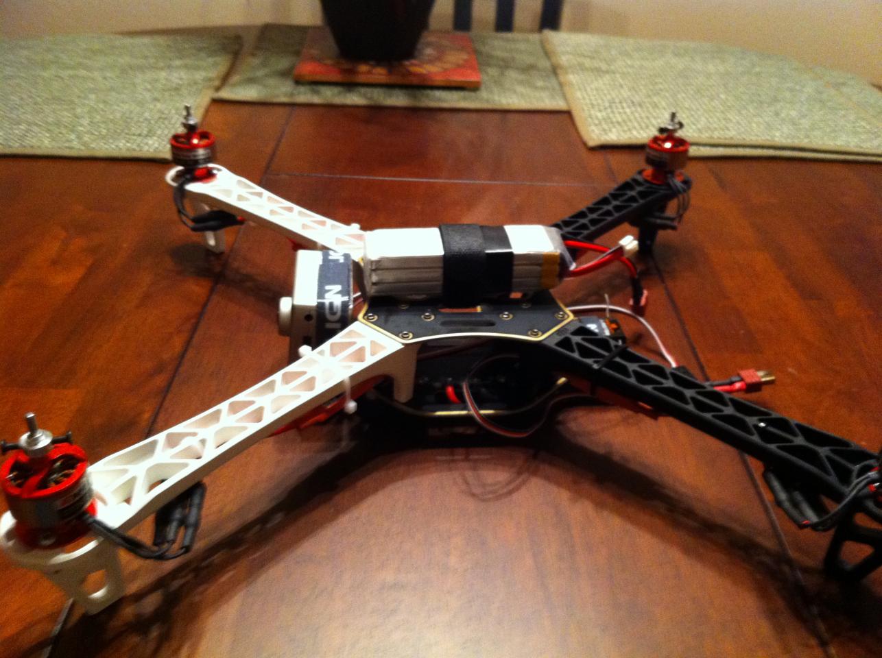

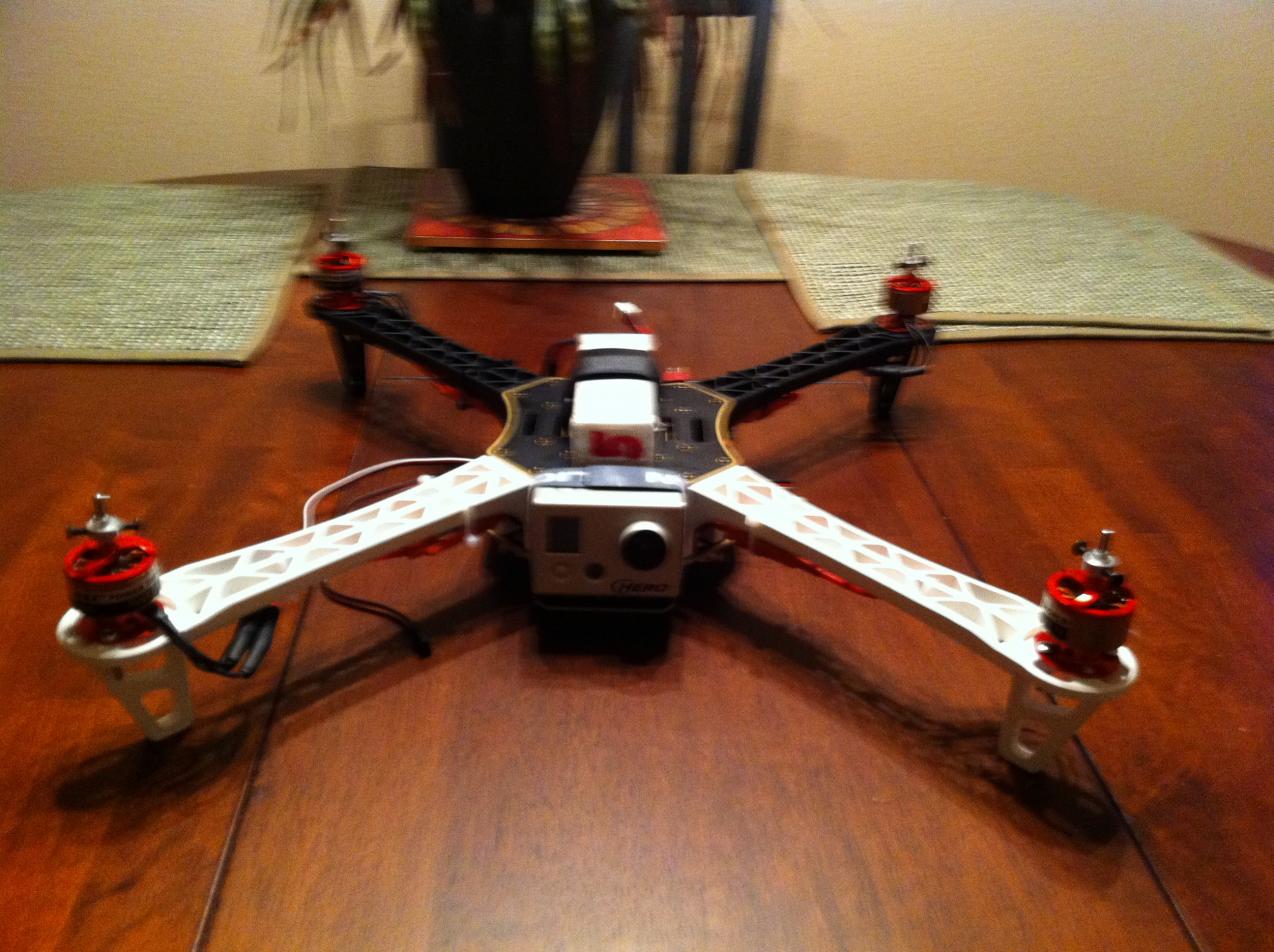

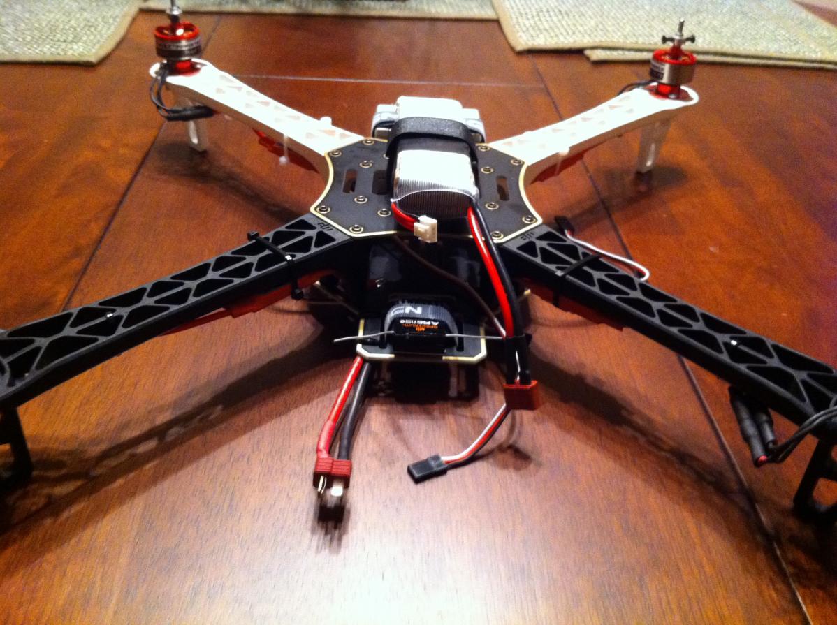

View attachment 1752View attachment 1751View attachment 1750
Jack, you are welcome. Several of us got F450 frames from a UK dealer. Since I blew an esc today and while I am waiting for a replacement, I decided to start a build of the F450 with what I had laying around. Here is what it looks like.
RC Timer 2822 motors 1200kV
Turnegy Plush 18A escs
AR6115 Rx
2200mAh 3S Lipo
8x4.5 Gaui Props
GoPro
Right now the AUW is about 800g without the FC and props. I am thinking that I might put on one of my vTx's on and make it a full FPV machine. I am waiting on my Naza Kit. I decided to do the full kit rather than just the controller to see what "magic" DJI had in the complete package rather than my 'TimeCop', I fly junk set up. I will put the Naza on this for S&G. Other than the GoPro there isn't much on it worth anything and I have a bunch of 8" props setting about that I will never use again.
