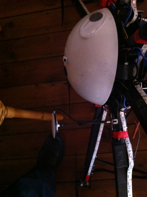

I had a few TBs I found off setting my gps to the back fixed it..
Thanks nytram,
Do you mean you actually physically offset it or in software ?
I'm not sure why this would happen when absolutely nothing on the machine changed except a lens.
nytram
No I moved mine back. It was in the Center now it's mounted on one of the armsView attachment 8714
