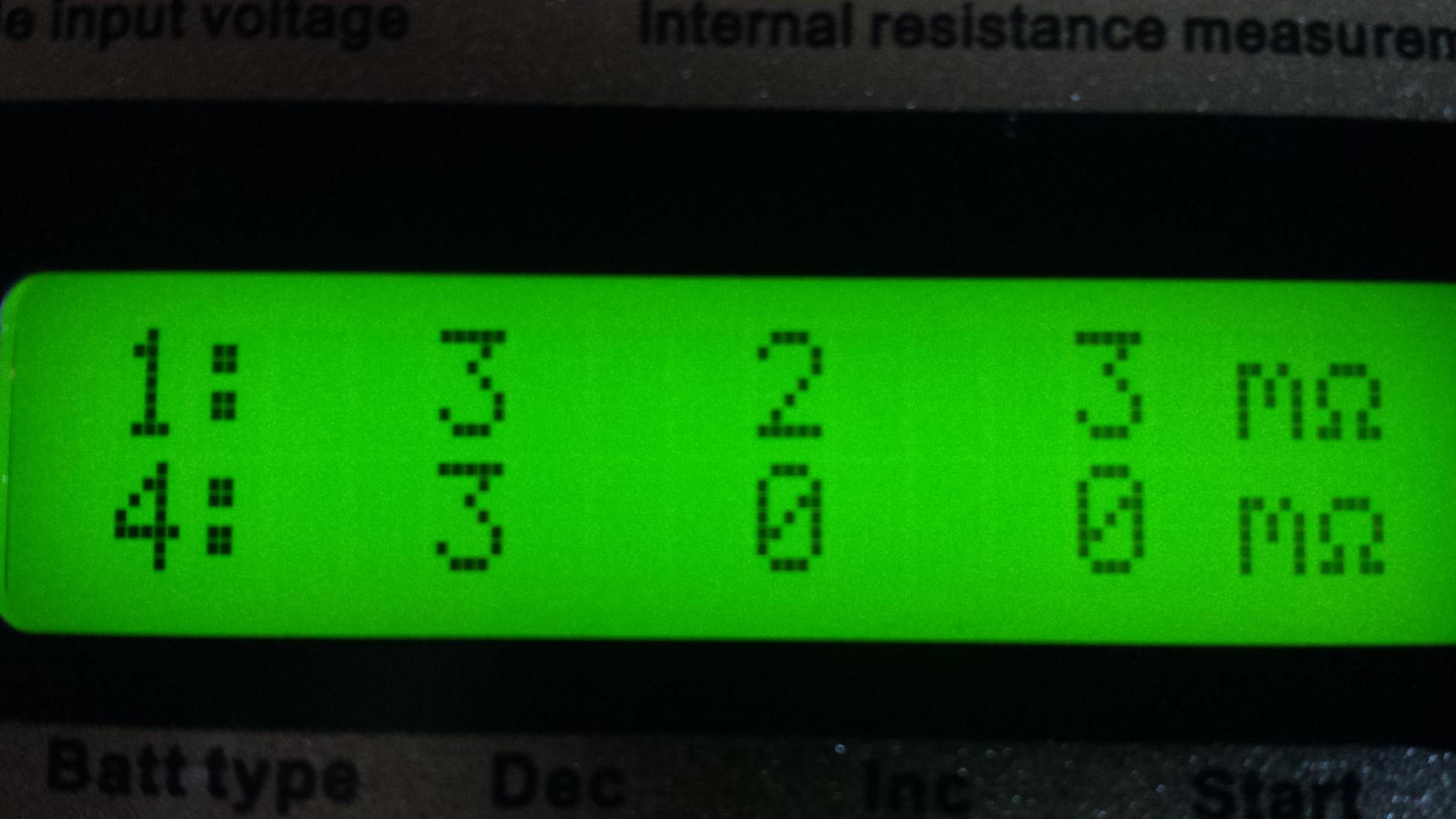

Picked up an Icharger.
IR readings 10AH4S Multistar 10C.
Continuous current [A]: 141.4
voltage drop per cell [V]: 0.424 total voltage drop [V]: 1.697
Continuous C rating: 14.1C

Alot have been saying that the Multistars probably can't deliver the goods. Mine does, tests out at 14.1C.
Means it can deliver 141 amps without damage.:tennis:
I like my icharger quite a bit. That IR function is killer.
good news on the multistar batteries. At this point they are all fairly small in the 6S category - hoping they make some larger packs soon to try.

Cool. So how does that charger do continuous amperage? 141A is a lot to pass.
