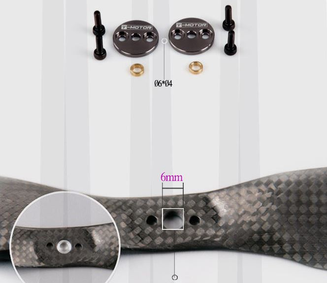

Just got around to balancing the knockoff T-Motor style bolt-on props I got (I know, I know. Maybe they'll never balance - but I'm going to try).
Wondering how you all are balancing the hubs? The "hub" area is so thin, I'm wondering how I could add any CA. Are you removing material from the heavy side? Only balancing by removing-adding to the leading or trailing edge?

I am assuming you are talking about the attached prop type from Tiger-Motors..... see image. Much of the hub strength comes from the bolt on washer/clamp which wraps around the edge of the hub to add strength. There is not a lot of hub to create an imbalance to begin with. But if there is imbalance, make sure the holes in the hub are precisely centered to the prop diameter axis. If not..... try filling it with JB weld and re-drill hub holes, undersized then use a very small rat tail file to carefully increase the diameter etc. or use the brass inserts View attachment 18020

Scott: yes, this is the type I'm talking about. So far I've just thrown 1 up on the balancer - and it was pretty close already. Didn't take much to get it right. But good tips for if/when they are more imbalanced.
