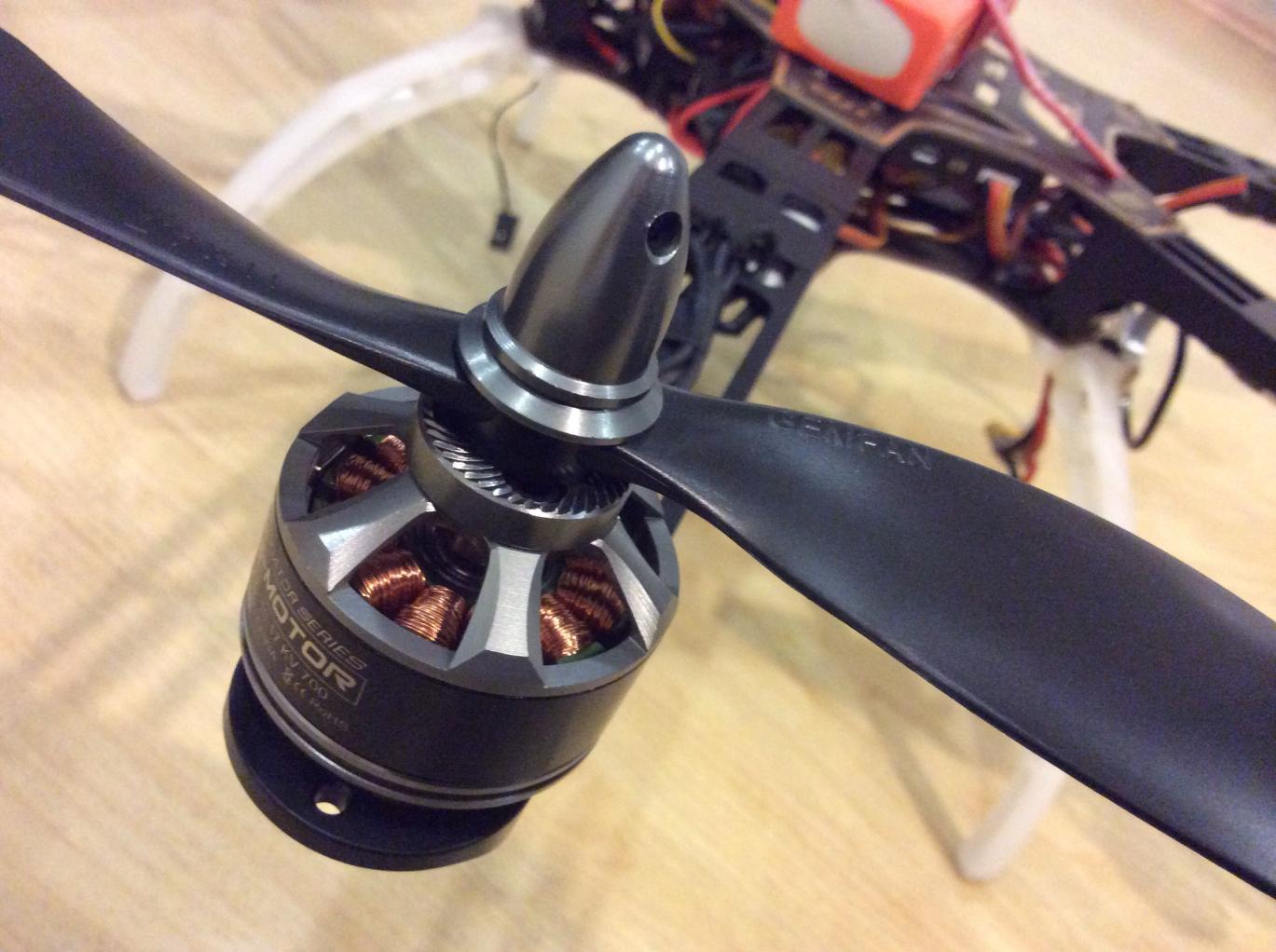

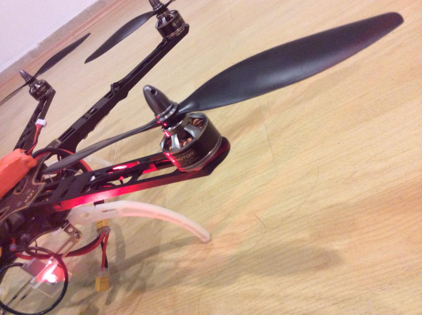

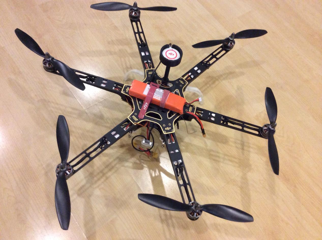

I fly my F550 with these arms with AMP 2814 770KV, 2x4S 4200mah batteries with 11x5 carbon props AUW 3kg and handles very well. Your CG and gains will have to be adjusted.

I recently bought a extended aluminum arms for my F500 with T-Motors 3110-700, but all flights have been a disaster.
the first flight lasted a minute before it fall down and broke 2 new Maytech 11x5 carbon fiber propellers. That flight was very untestable an very hard to control the drone. My F550 weight is 2400 g, and I was using 4500 mAh 4s 35c battery.
After that I try with 10x5 Graupner props, with almost the same results... Untestable and very hard to control it... Crashed and two broken props. I try also with 11x4.7 Gemfan props with 8000mAh 3s 35c battery, just little more stable but hard to control it. With very strong tendency to turns yaw on CCW direction. Before I change the arms, I was using stock DJI motors with Stock DJI 10x4.7 propellers and it flights very well with 3s and 4s batteries.
what kind/brand of propeller do you recommend to use with extended aluminum arms?
