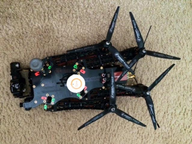

Hi Kloner I recently took my Disco Pro on a trip and for easy cary on board inside a backpack I folded the DJI arms back by taking 3 screws off from the top and 1 on the bottom of each arm so the arms pivot back this made a more friendly way to travel to my destination
my question is would this work with the MOB arms if so can you or some one take a picture and measure how long and how wide the copter gets folded
thanks

sorry i missed this, yea they would do the same thing, just alot longer. the booms are 12.5".

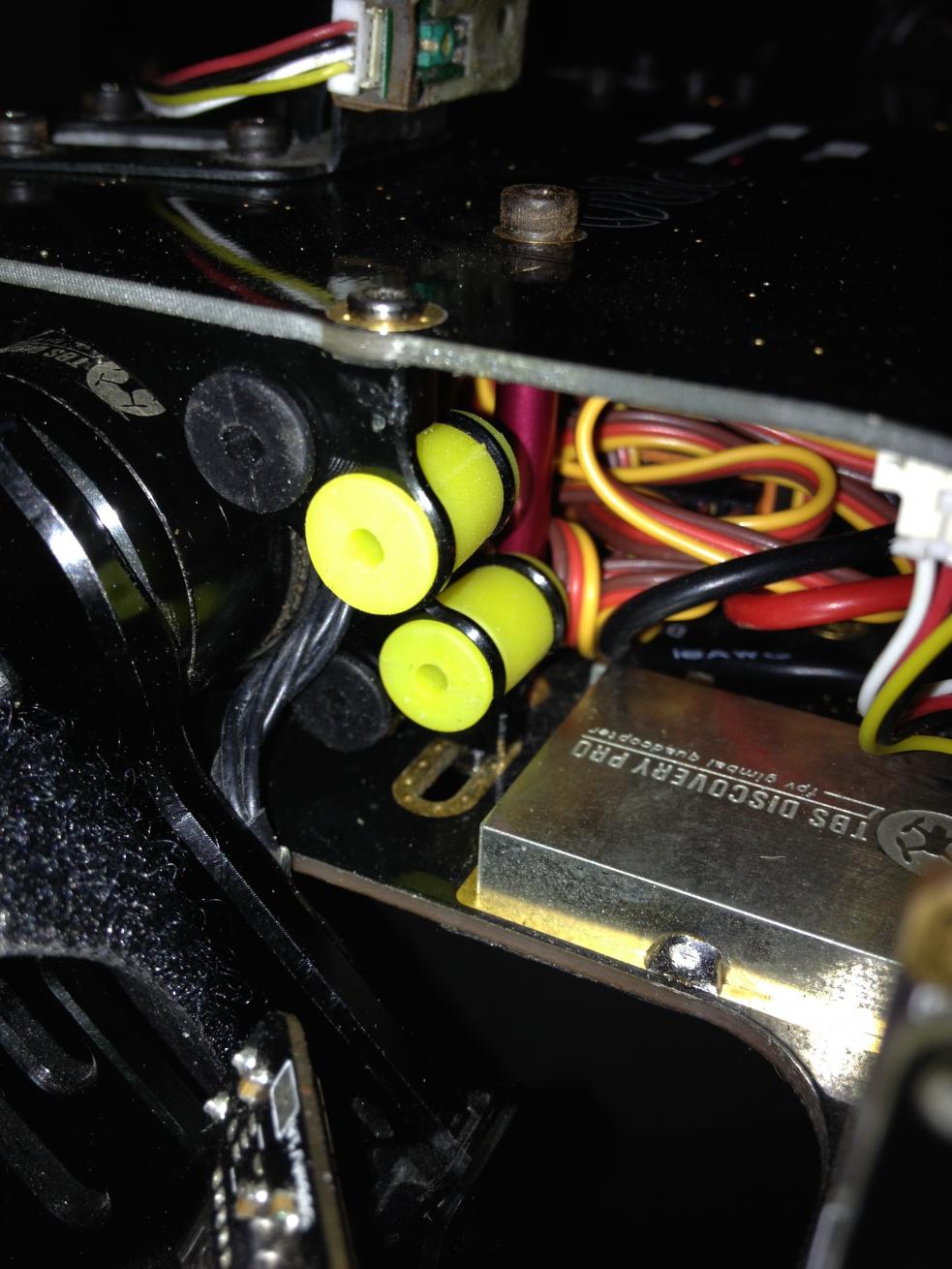

i've been playing with various 400kv power options, am settling in on a decent vibe iso setup for 13 and 14" props. Still working on perfect iso on the 15's, there tough to tame
attachment.php
attachment.php
attachment.php

looks like those draw the least i seen yet from you vids. sweet...
