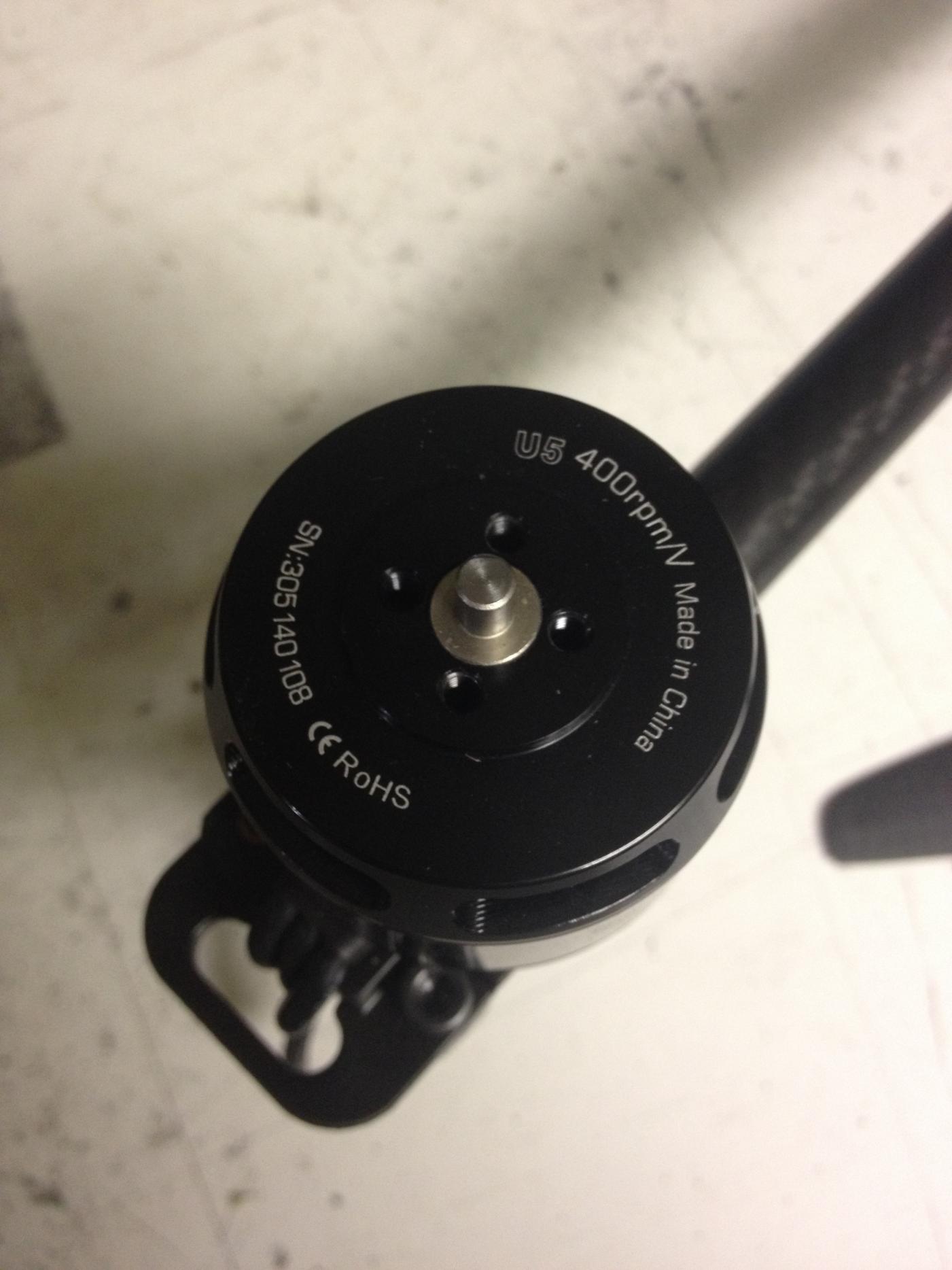

I'm curious what's going on there. It's not obvious that the shaft is bigger than normal, or that it's using different bearings from normal. The U5 shows a 4mm shaft only. Kinda small for a motor that big, IMO. I think they just got rid of the C-clip retainer and use some kind of screw fixing.

heres that whimpy 4mm shaft on at this level small motor View attachment 16200
looks like 8mm going into the top. u7 looks the same. There like pancake motors with a ton of top and bottom stuff. cooling i guess. very vibration free out of the box. i had alot of 3520 come out of the wrapper just not up to par.
