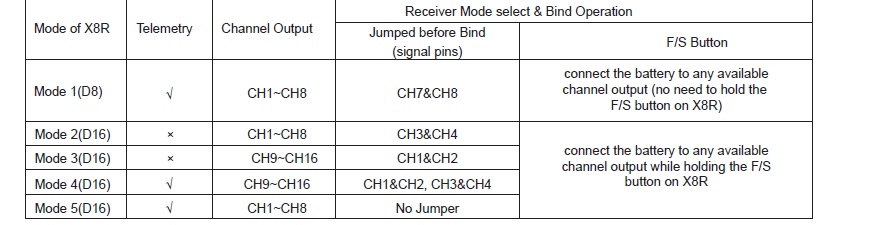

The Tiny2 wants 4 channels, but removing roll eliminates one. 1-8 S-bus Naza, 9-11 PWM directly to the x8r.
Bind the receiver in mode 4.

I did the bind on my XR8 to enable channels 9-16, then plugged the gimbal cable into pins 9,10,11,12. Now I've mounted my Tiny 2 gimbal, installed the Mac USB driver and the Tiny 2 configuration software but it isn't isn't recognizing the device. When I power it up, the gimbal rotates counter-clockwise slowly by itself. It gives me some control with the right stick of my Taranis for some reason, even though I have no switches programmed to pins 9,10,11,12.
