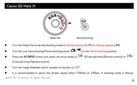

The manual says that you even "HAVE TO" turn off the IS!
Thanks, have been trying to find the answer to this for a while for MR flying.
Which leads to the question, why on earth did DJI select a lens that had built in Image stabilisation, do they just select the first lens that seems light and has a wide focal length.
Half the money for that lens probably went into the image stabilisation.
If they would have thought about it a bit more then they could have picked a lens that was around 600 grams like the 16-35mm (and weather sealed).
I know its twice the weight of the 24mm but how much of a difference would it really have made, there are quite a few great lenses around that weight, which you could maybe have swapped over and not been stuck with one lens.
yeah I'm totally with you. doesn't make sense. but hey, i guess its an awesome is lens to play around with on the ground ;-)
DJI says the gimbal can hold the 24mm 2,8 is "at the moment". so they might some day release an upgrade kid to be able to fix other lenses. that would mess up the internal gimbal control adjustments though. I think dji creates awesome products. but they don't really let you know anything about their new products until they put them on the market.
