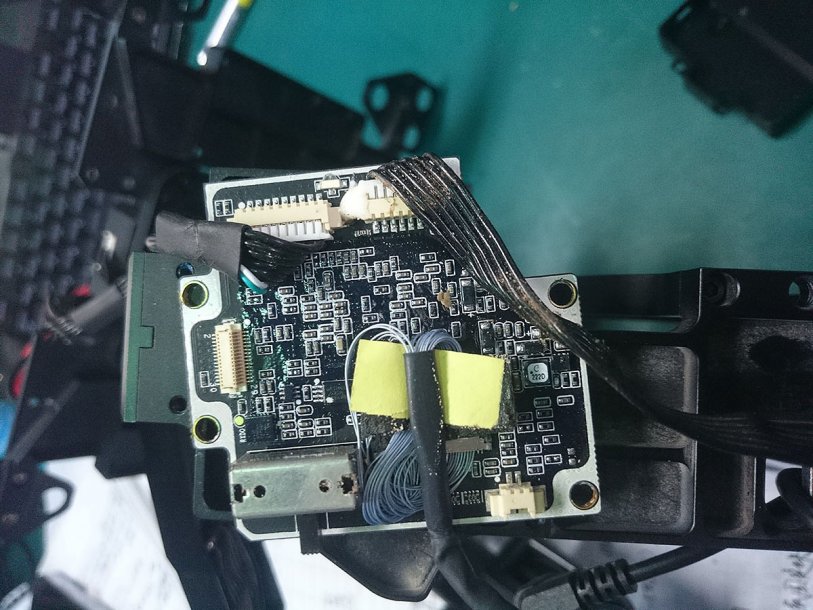

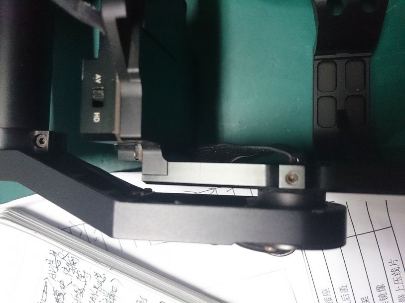

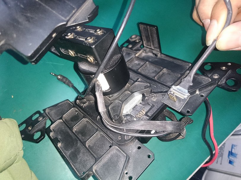

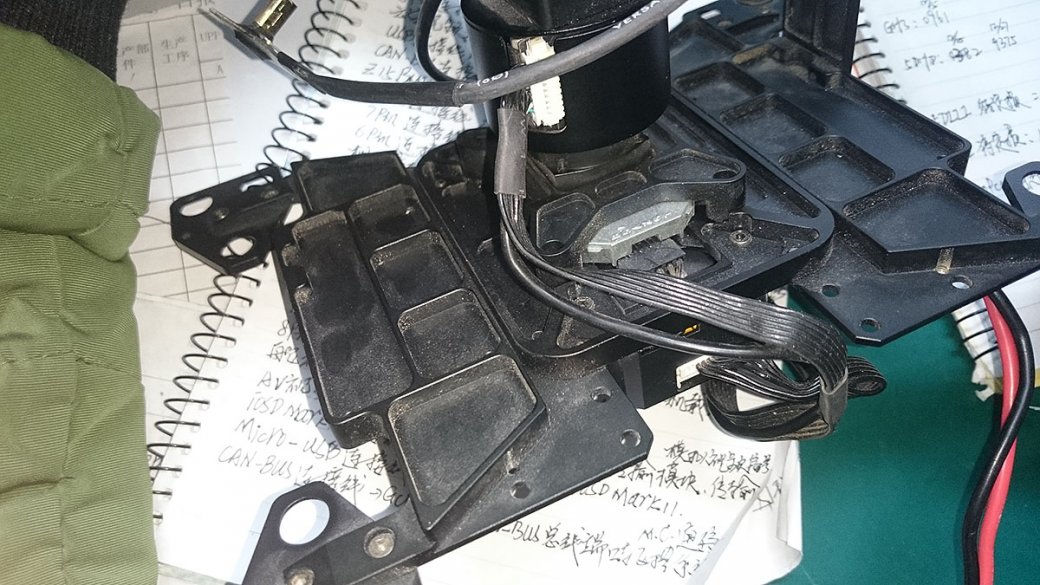

I just had my first experience with "warranty"...
I just waited 8 weeks on a warranty repair of a zenmuse GH4, which suddenly didn't put out any video downlink anymore. The gimbal still worked apart from that (apart from the odd trigger not working etc.) :-D
I got notified today that the gimbal is dusty and that they can't cover it by warranty and that it is a WRITE OFF.
Hang on you buy a car and it gets dust on it and the warranty is GONE???
Can't believe that, if you want actually use the gimbal in a professional environment there is no warranty as such.
GH4 Gimbal Serials 0220021556/01z0050530 (dji Case number 141212ZHG)
I also attached the "proof" (photos) of dji that the warranty is not applicable, for me it's proof of a used gimbal.
I also attached typical location where we take off so yes there isn't always a dust free environment.
