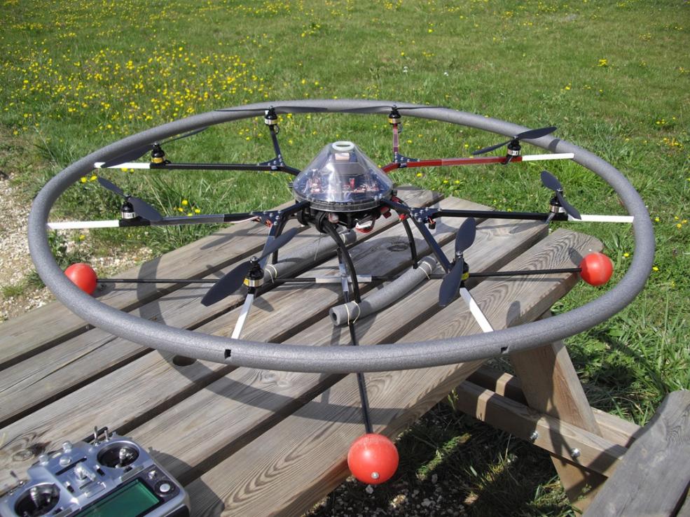

And just to illustrate how far back to the beginning I went ...
