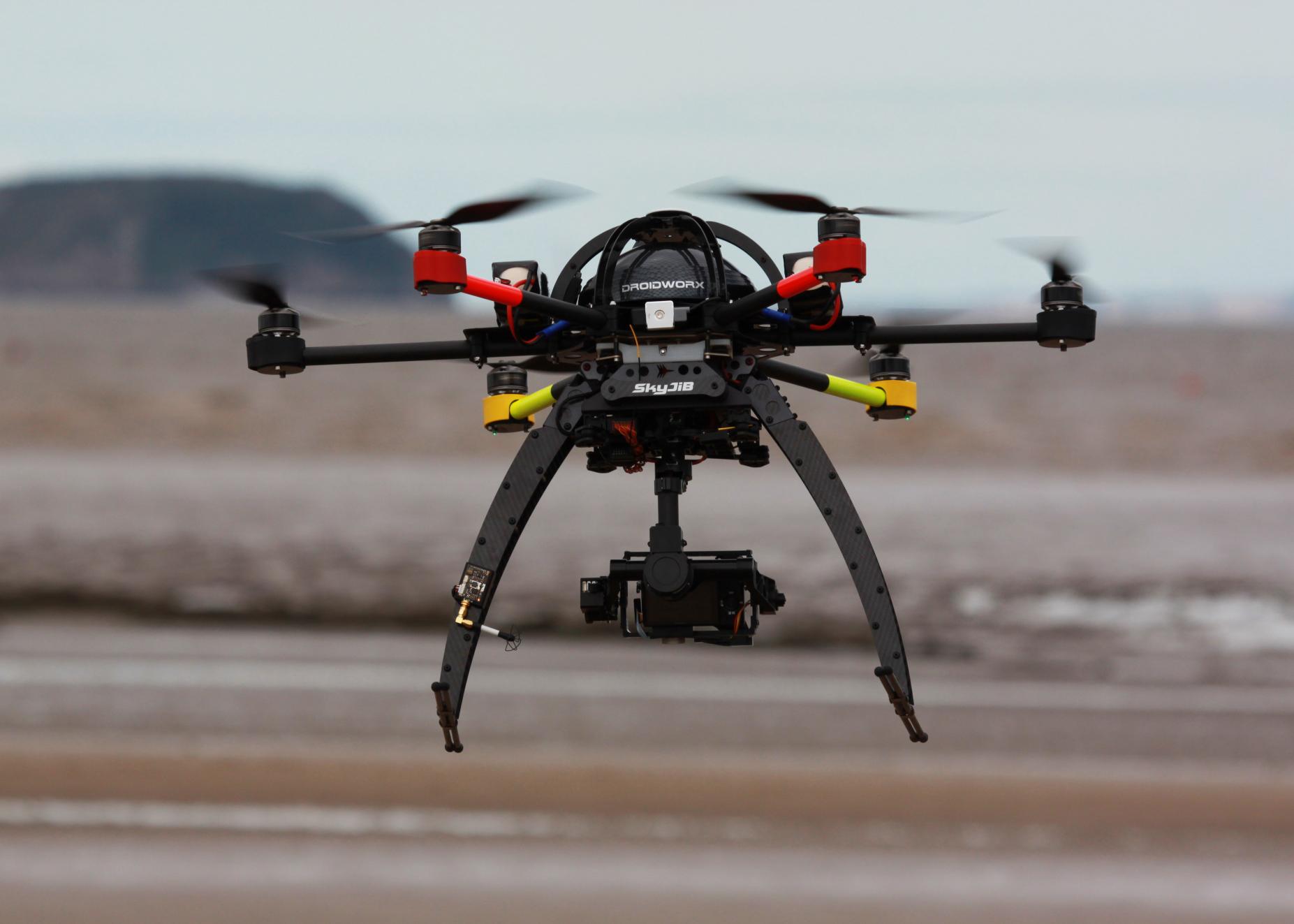

here's some footage I shot in 25knts+ wind, the karts saw 35mph that day :) using wkm
