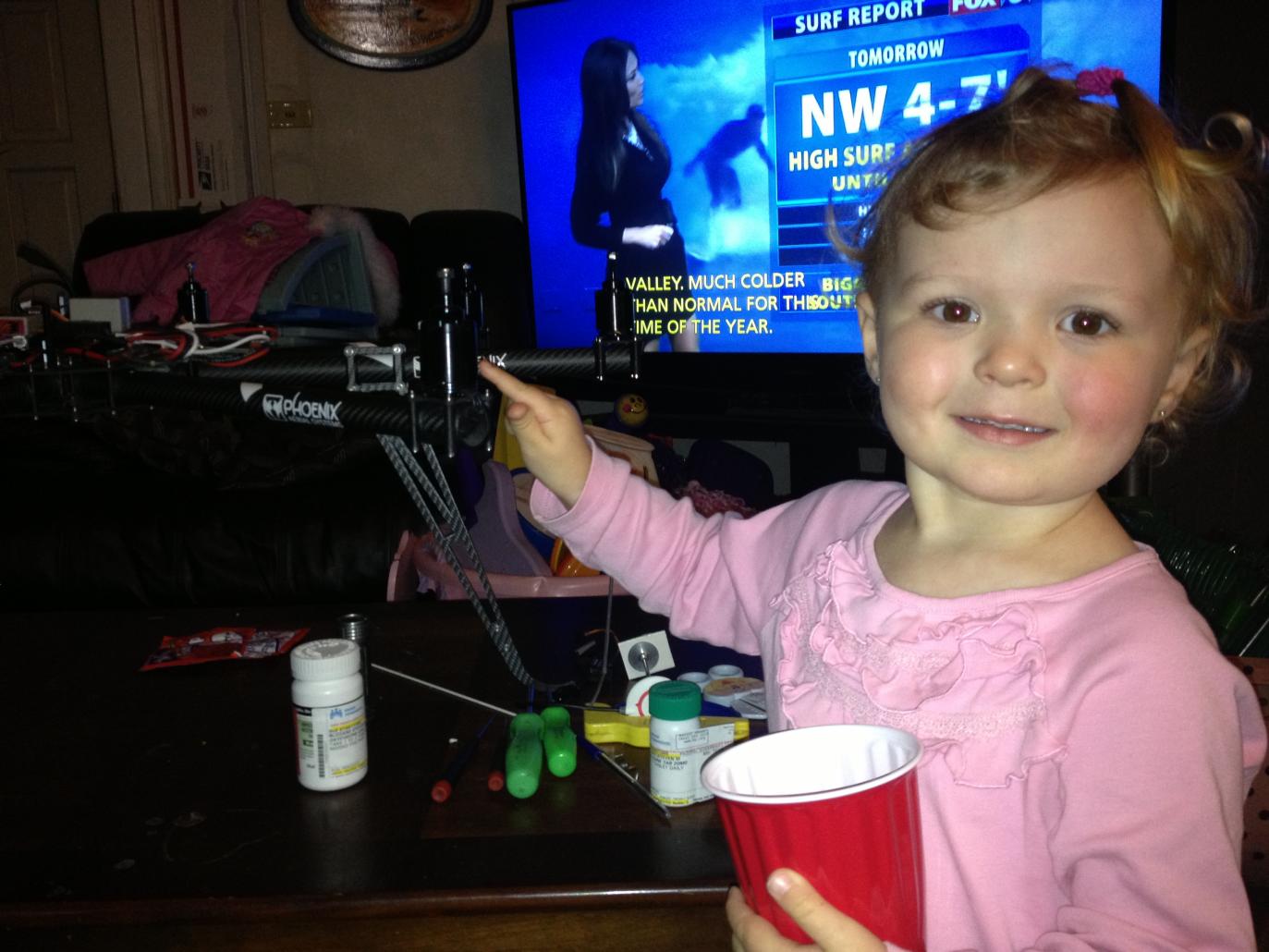

finally got the chopper back from the lidar conference and gave it a going over. the 3 rear motors all had intrusion into the winding, but on in particular was extremely punished. ironicaly it's the one that ate the esc as well so this is pointing in the right direction, has to be. Got it all together just waiting for a sober pilot to give it a go. At the same time, there is some weird buzz out of the WK firmware camp and i think some of that problem is what i'm seeing with the motors starting stuttering mid flight.
the weirdest part is my kid walked by, i said show dad whats wrong, she did this..... kids got it in her blood

Kari
Agree, kids just have it on blood. :) good to hear it's beginning to solve out. Usually these have a simple explanation. It's something that should be warned in the package of every motor. I guess ruining coils is something quite common for unexperienced builders.
