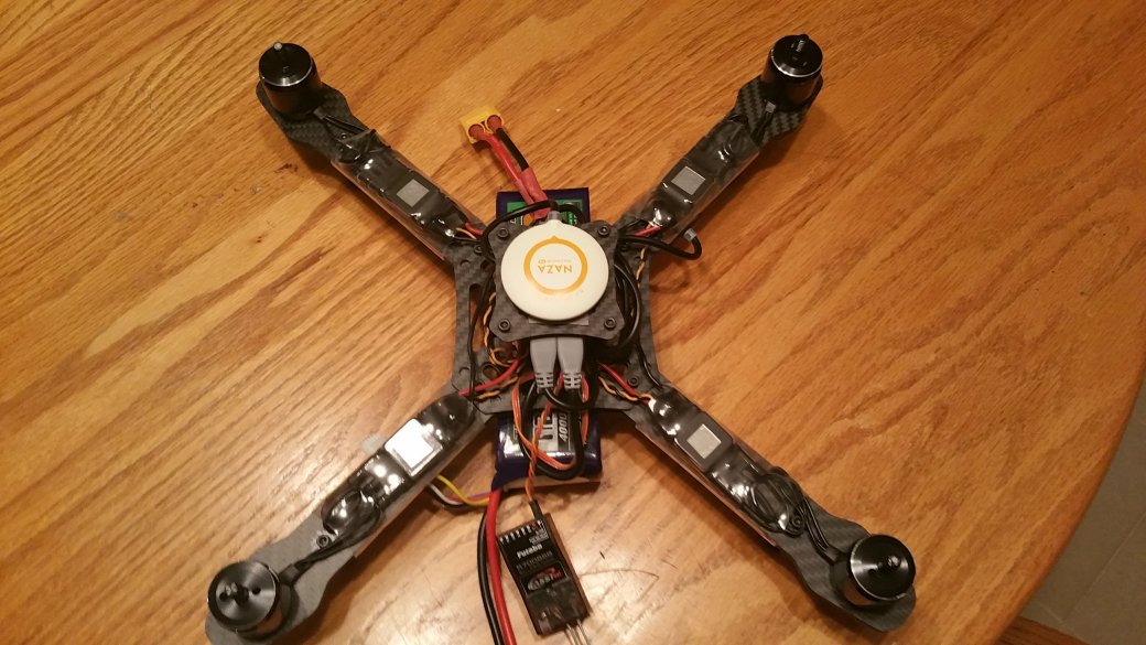

I just built a 350 sized armattan quad as a trainer. Something that will take a shite kicking.
Naza V2..... Tmotor 920kv and 20A air escs.
Got her all done. Downloaded dji windriver then Naza V2 assistant.
I have been working at this an hour. Cant get the assistant to see the naza. She appears to be working. I am getting satillites.

Pic
