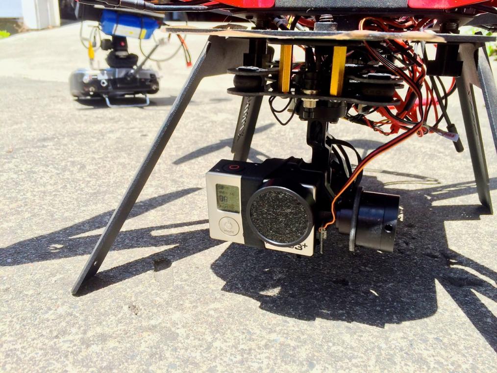

I bought the Polar Pro for it's lightness (10-12 grams) so I could use it with the DYS 3-Axis Smart gimbal. It acts as a good sun shade and is light, but I found it totally molested my image. Everything look soft. I've been working with Snake River Prototyping to get a smaller / lighter / better go pro filter that we can use on about any GoPro gimbal. I've done a lot of testing of prototypes, and now they are coming out with the "BlurFix Air" that comes in at about 7.6 grams, and has amazing glass. I'm getting my final production models this week to test and do comparison vids with. They will have an ND4 (.6nd), a CP, and a CP/ND combo. I'm excited. My gimbal has not complained about the filter. I personally don't use that metal clamp that goes over the lens, and makes the lens harder to put a filter on, but for people with Tarot type clamps, there is a cut line in the tube that slides over the lens, so you can make it shorter to accommodate that clamp. I hate the clamp and use a fat black rubber band. Anyway, these filters should drop in August. Attached is a photo of a prototype. Also there will be an optional sun shade you can clamp onto it, though it keeps the prop flutter away pretty well.
attachment.php
Here's a test I did checking out the Polar Pro against no filter, and you can see how soft the image is. Their ND is way darker than it needs to be, and causes the shutter to slow too much IMO. It also casts everything blue. At first glance one may think the image is better with the PP but it really started bothering me.
attachment.php
