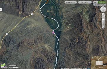

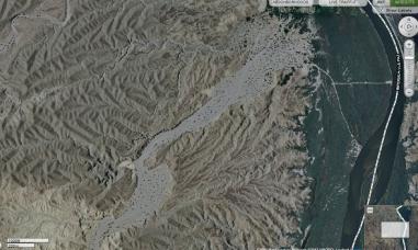

The area i'm going is a proving ground for the military. just hoping i don't get shot down, but is wide open space, no trees, but there is washes and small hills along side the washes i'm a little worried about. If i was gonna get down in a wash, am i better off standing down in the bottom of the wash or up the hill along the side of it? the hill would have no trees between us, down in the bottoms would have 20' mesquite trees around me

As for your flying location, with any radio signal, height is usually everything so you'll generally be better off flying from the hill than the wash. The best view will usually give you the best radio signal as long as you stay within range.
