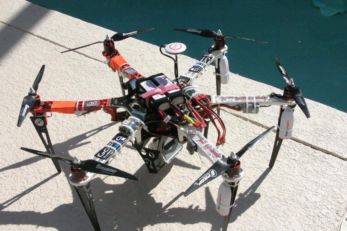

Here is a pic, I put them on 3 legs. (not sure how to enlarge the pic in the reply, but you can click on it to enlarge it)
ChrisViperM
gencode...looks good, but I would mount one float on every 2nd leg to spread the "float"....otherwise you have half of the rig above water and the other side will be a "diver"......

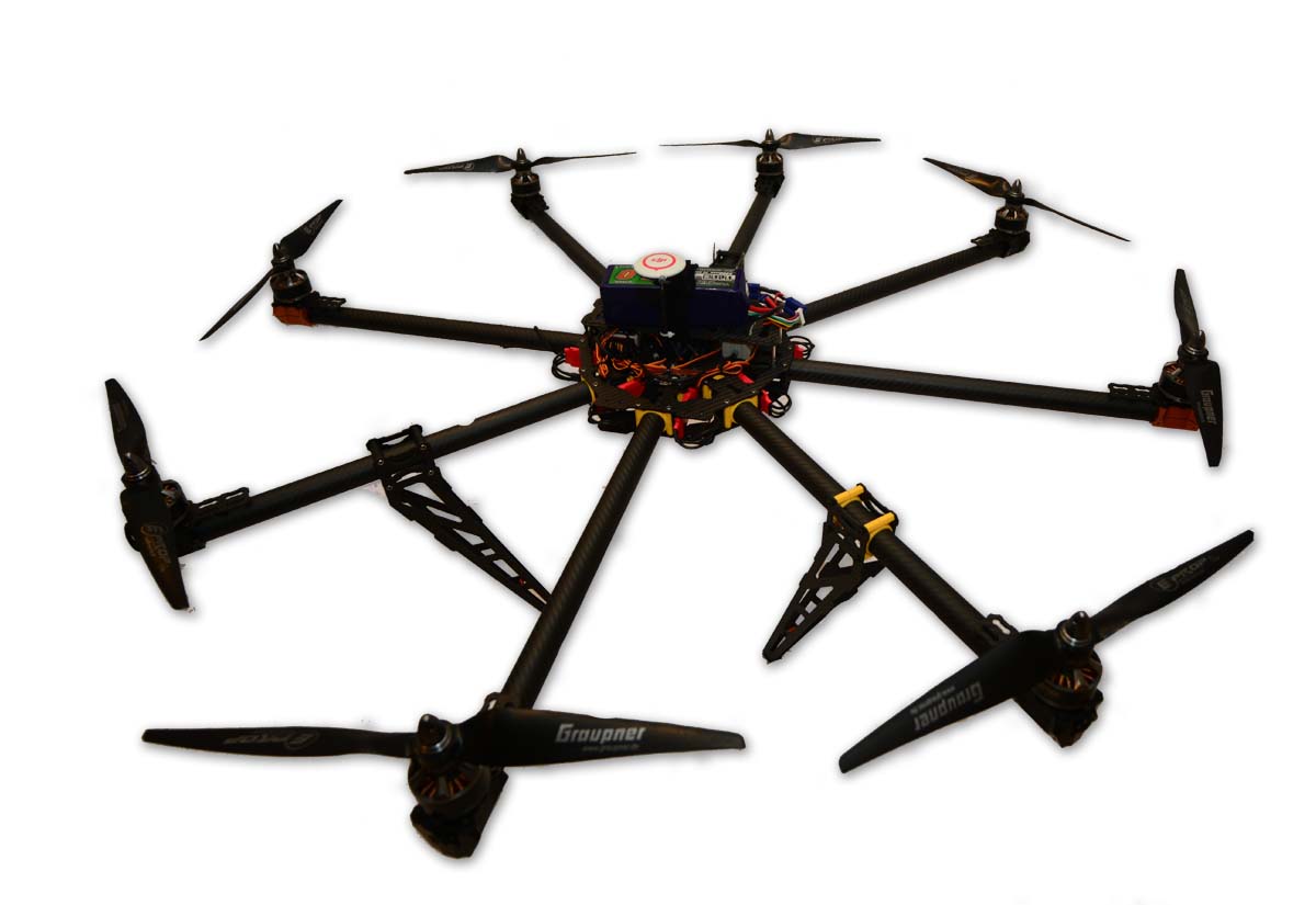

Anyone know of a larger version of this? I have a 1000mm octo that carries a DSLR. I'm not sure of the weight but I'm sure it would take quite a few of these to float it.
rsun
They lift 1 kg. so just use one for every kg the unit wight.
Understood... for an F450 or 550, that is a simpler solution since it would only require 3 or so. For the S800+Z15, it would technically require 7, and I was curious if anybody has come up with an alternative solution for that.
rsun
If you give it 1 on every arm the unit would be about a meter under water and given you 6 led flash the should be easy to see.
