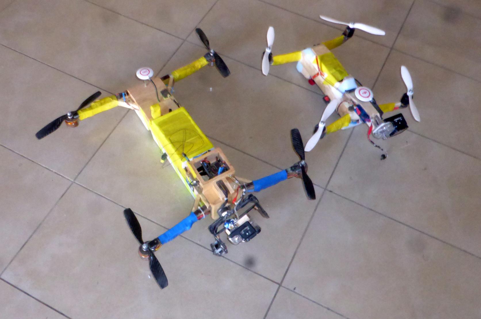

The machines that I use are Phantom size, so only 1100 grams with a 6000 mah. bat. I spend a lot of time with the I-phone/vibration APP. An invaluable tool if you want a really stable machine that is also efficient. They are made from carbon, balsa wood and foam. They are not meant to be crashproof as that is not an option plus they must float on water.
You can do a lot with a GoPro black these days......
View attachment 13274 They probably look a bit rough round the edges compared to some of the off the shelf offerings but they are designed and in constant dev. to do the job and try and stay ahead of the game. Everybody and his dog now has a phantom and to be quite honest a phantom can do a lot in the right hands.
The next GoPro and Cineform software could be the final nail in the male jewelry heavy lift syndrome coffin. That would make our chances of long term survival much better.

Actually the carbon props. on the larger machine are mounted in a special way and have no bearing on the technology used on the smaller one. The motors which are rewound and balanced to a very high standard are mounted on arms that have a very high torsional strength and if you look closer you will see that the motors are rebuilt so that the drive shaft comes out of the top. This results in a prop. to mount surface overhang of only 6mm. Actually the shafts float softly against the thrust bearings. (magnetically Centered) Coupled with this the ESC's are tuned to these particular motors and this is also a factor in producing the kind of smoothness that is required if you want to even start to think about suppressing aerodynamic harmonics.
The other machine has the motors mounted in the conventional way and as such uses only very light plastic props. 8x4. In comparison to say a Phantom the vibration level is in the order of 50x less than on the samples tested. You should get yourself some proper equipment and start working with facts. Wild theories and guesswork never worked in F1 and they don't with MR's.
As visitors to my workshop will attest to, when I place my Vib. APP on the side of an arm I get three straight lines in the X,Y and Z. The minimal signal that can be seen is the slight Japanese bearing noise.
I have yet to find a high end standard motor that is anywhere near balanced properly. FWIW.
