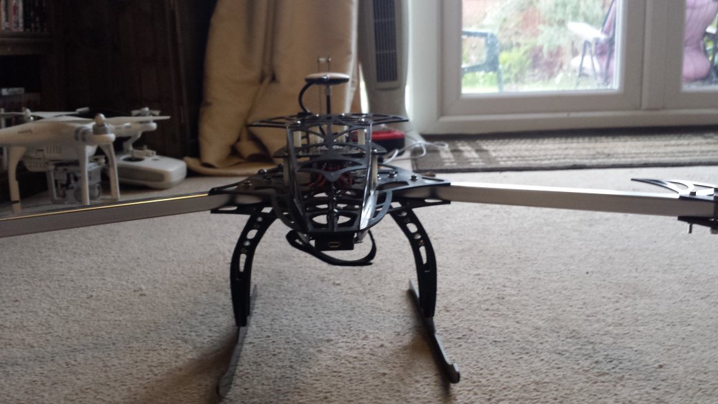

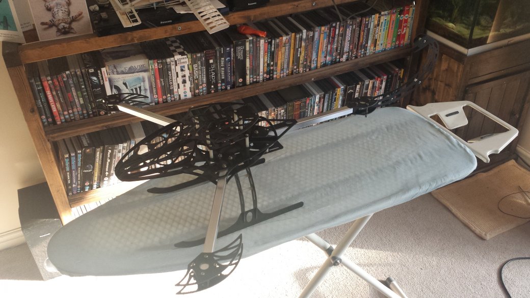

nismo
Maybe not to everyone's taste, but I like it, something completely different! Big enough to allow lots of expansion too, so ticks all the boxes. Really want to go for the triple bladed folding carbon props, they look awesome, will make transportation easier, and the triple blades will keep the Y configuration theme
Old Man
It does look cool. The square tube arms are quite practical, making for easy to obtain replacement if damaged. They also allow for a lot of length experimentation if desired. Looks like a little imagination will be in order when mounting motors though.

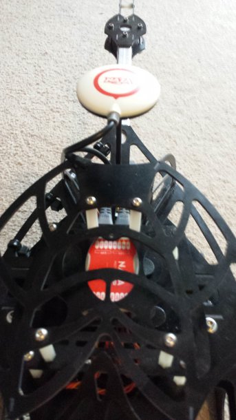

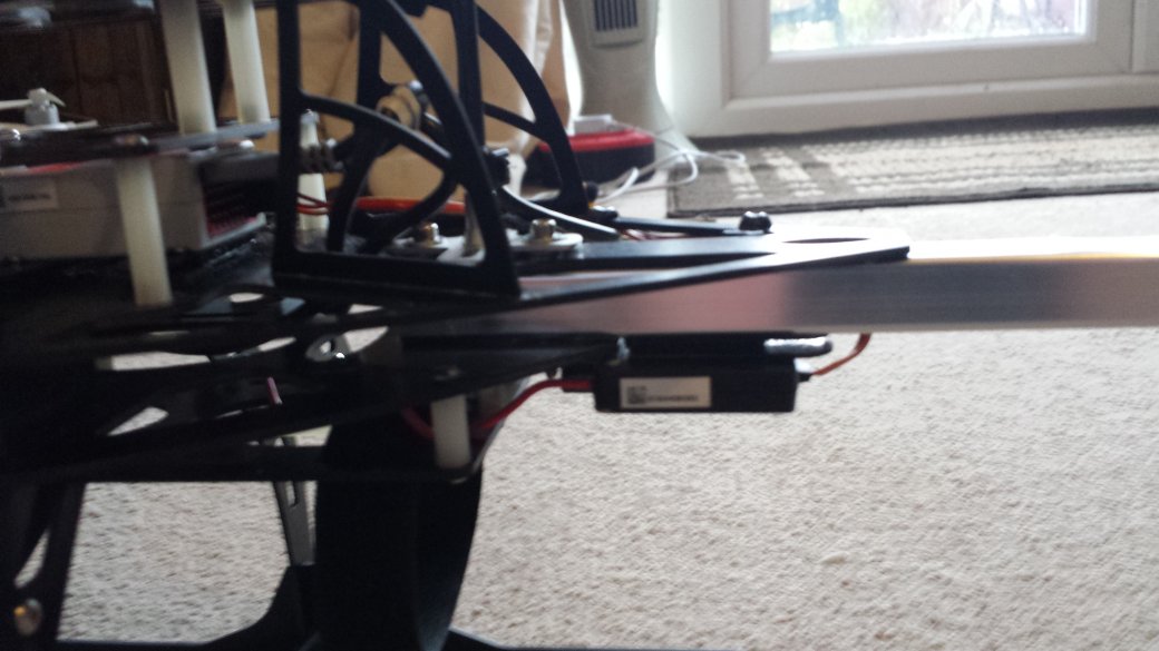

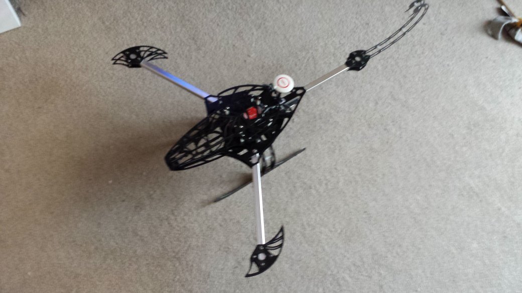

nismo
Flight controller arrived today and fitted :) Went for the Naxa Lite in the end, one came up at a really good price so that was the decision made! Was a bit worried that the GPS module would look out of place, but think it looks ok now its on. Have a bit of an OCD with wires, hate seeing other home made multis with wires everywhere, looks awful in my opinion, so spent quite a lot of time laying everything out, and planning on where all the stuff that I haven't got yet is going to go. Even went so far as felt patches over any edges of the frame that a wire runs over to stop any chafing So far, very pleased with the results.
