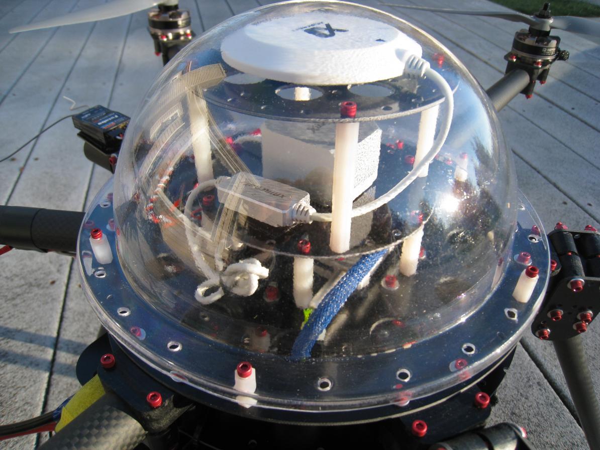

My 1000mm frame has a hole in the middle, too. Move the IMU forward slightly to the edge of the hole, set pitch gain 0.1 lower than the roll gain and you're done. Easy fix.

Ross, I have a Rusty's hexa as well, just curious, how do you keep your motors/mounts level? Straight edge, spirit bubble? Do you have a hole drilled into arm and mount for orientation? Any particular reason your receiver is outside the dome?

I just use my eyeballs to look from the end of each arm and line up the motor mount flat with the main frame flat. I'm not sure that any additional accuracy would really do that much good :)
I mounted my receiver outside of this dome since I always want the diversity antennae to be at 90 degrees from each other. It is just easier to mount it outside. In the past, I have mounted it under the dome and drilled 2 holes in the dome for the antennae to poke out through. That worked well and added a high degree of protection.
