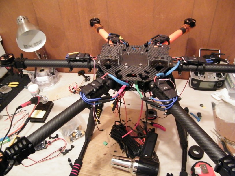

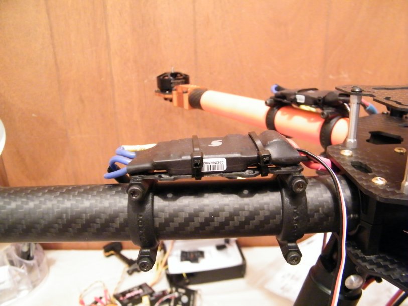

I'm not as far along as you and mounted the ESC's a lot differently. I'll post some pictures a little later (it's still an electrical nightmare) but the short version had me obtaining a lot of parts from a T-1000 so I used the tube clamps and ESC mounting plates from it with a little rubber tire CA glue to relocate the ESC's to the inner top side of the booms.
Old Man
I'm temporarily setting up with a Vector FC until a new Pixhawk arrives. Until then here's a couple of pics of the unfinished snake pit, mostly for showing the ESC mount.
