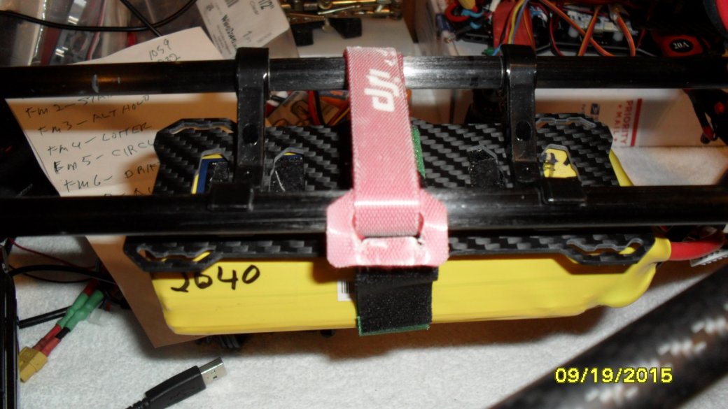

Well they say a picture is worth a thousand words so here goes. The pink strap is pulling the rails together.

See the tabs with the slots in them to the far left and right? In your photo they look to be coming toward the foreground under the rails. The straps should fit inside there and wrap the battery in the same direction you have it now.
Motopreserve
Sorry. The pic made it look like you weren't using the tabs.
If they aren't working for you - you'll have to make your own plates.
