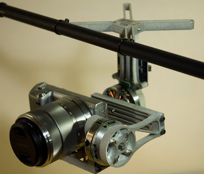

SleepyC
www.AirHeadMedia.com
R_Lefebvre
Arducopter Developer
Oh, that's who it is. Well, this:
Makes me believe even more it was not simple pilot error. Dude knows how to fly. Not a factory team smack 3D pilot, but he can easily fly in all orientations. Probably flies better than some people who are laughing at him. He's better than me, I'm just starting to do acrobatics, and I know for a fact that I could recover from a simple "wrong mode" error, I've done it many times, and in worse situations.
