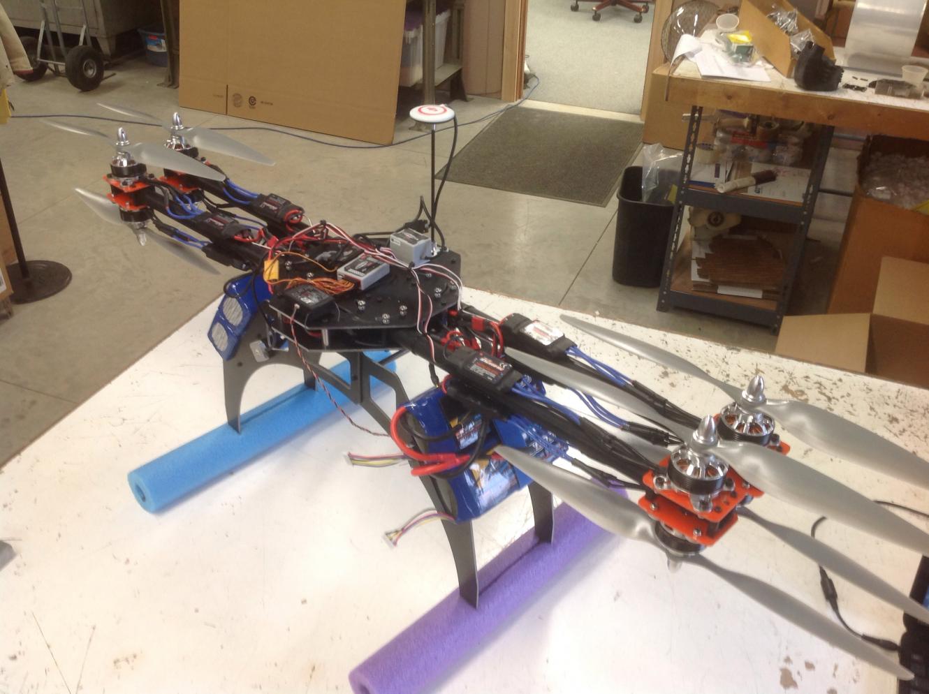

Finally finished my Quad 8, and a good day for testing...going to do some time testing and test how it holds altitude in FFF.
http://youtu.be/LbNdO07luM4
attachment.php
attachment.php
attachment.php
