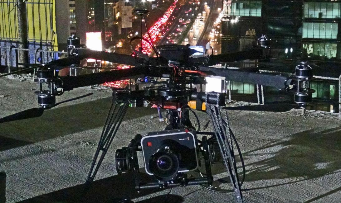

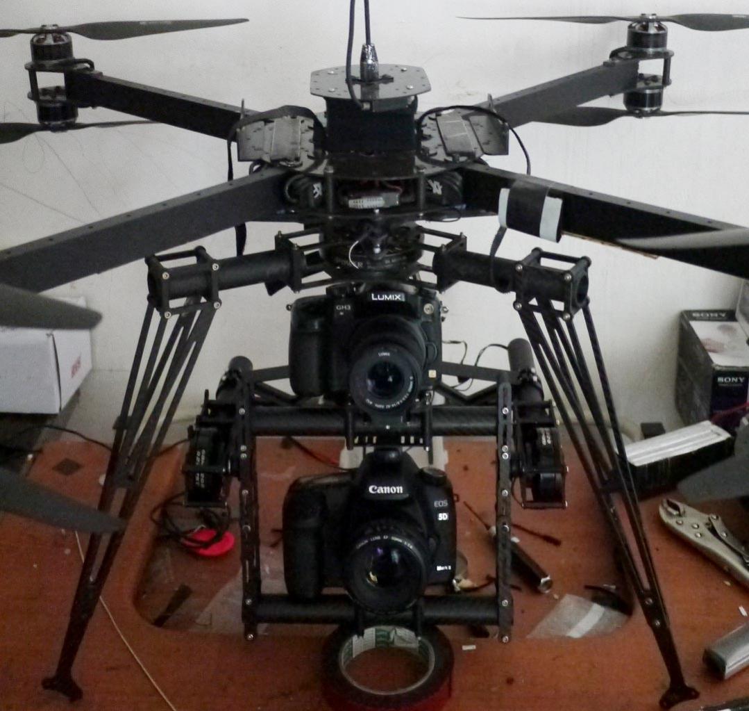

I have other KDE ESC instaled on other rig without problem, I did 1 time throtle calibration and work perfectly. Combos are: WKM, KDE 35 A ESC, Tiger MN4014 kv330, 17X5.8 Tiger CF prop, Hitec Aurora 9(picture attached).
I will try to recalibrate super X throttle as Kloner suggest(finger cross), Hopefully I got lucky
