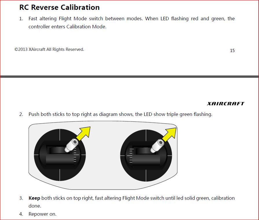

Still not sure what reverse calibration is, and if I need to do it!
Look in the manual - the third mention of a calibration shows how to do it. It just involves doing the flight mode switch dance quickly to enter calibration mode - and then putting the sticks in a couple positions. Then reposed and you're all set.

I attempted to do the reverse calibration 4-5 times yesterday. I could get the FC in calibration mode, but it would never register when I moved the sticks to the upper right. Also I seem to have changed something and my throttle on my Taranis does not tell me "trim center" when I'm centered. It just tells me whether it is maximum trim in either direction. Wonder if I have something setup improperly there.
You need to calibrate your radio first.... see Taranis manual, then you need to calibrate the radio to the FC see pics. Then you can get onto the other things.
