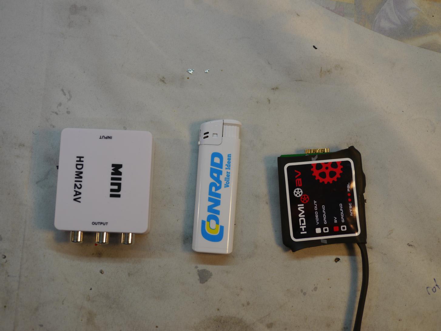

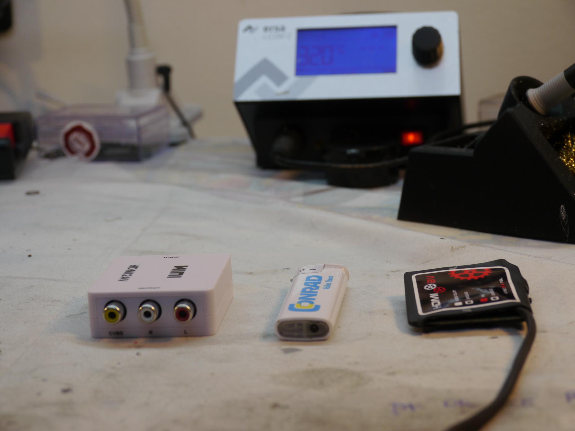

So, here are the comparison pic's:
View attachment 12401View attachment 12402
The case from the white converter can easily be removed just with a small screwdriver, and the 3x AV plugs could just be unsoldered.....cover it with shrink wrap and you get a light-weight converter.

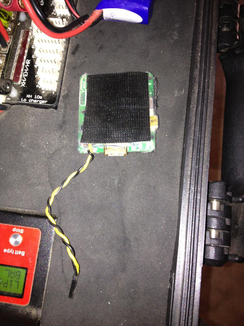

take the case off, unsolder the rca then solder on a video signal cable you get the right one from the left one....
we use the one pictured first post daily and is pictured remodeled in this post. important for it to be hdmi2av, theres a bunch of different ways it converts. nex-5 and gh3 power them through hdmi so theres no need to power them
