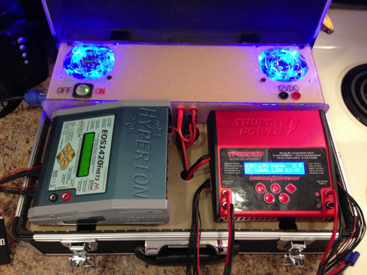

I'm using a TP 820CD and a Hyperion 1420. The TP does a bulk of the charging. I use the 1420 for finish balancing. I have on order a FMA PL8. I should be able to bring 6 packs up at a time - then finish balancing on the 1420, but that depends on how accurate the PL8 balances. I also plan on keeping a dead deep cycle battery on hand for 40a storage discharging. I just finished up v2.0 of my charging system. Powering this system is two 12v 47a server power supplies that I converted for RC use. The fans you see draw fresh air in on the right and exhaust hot air out the left. The power supplies have an internal fan that draws the air through each supply. There are 2 24v outputs and an auxilliary 12v output for chargers that are not 24v capable. I have consistently drawn 43ish amps from this setup without fail! I'm thinking about doing another case like this with larger power supplies.

Looks pretty cool.. Given me ideas of how I can spend more money :nevreness:

What server power supply's are you using? How much did they cost?
