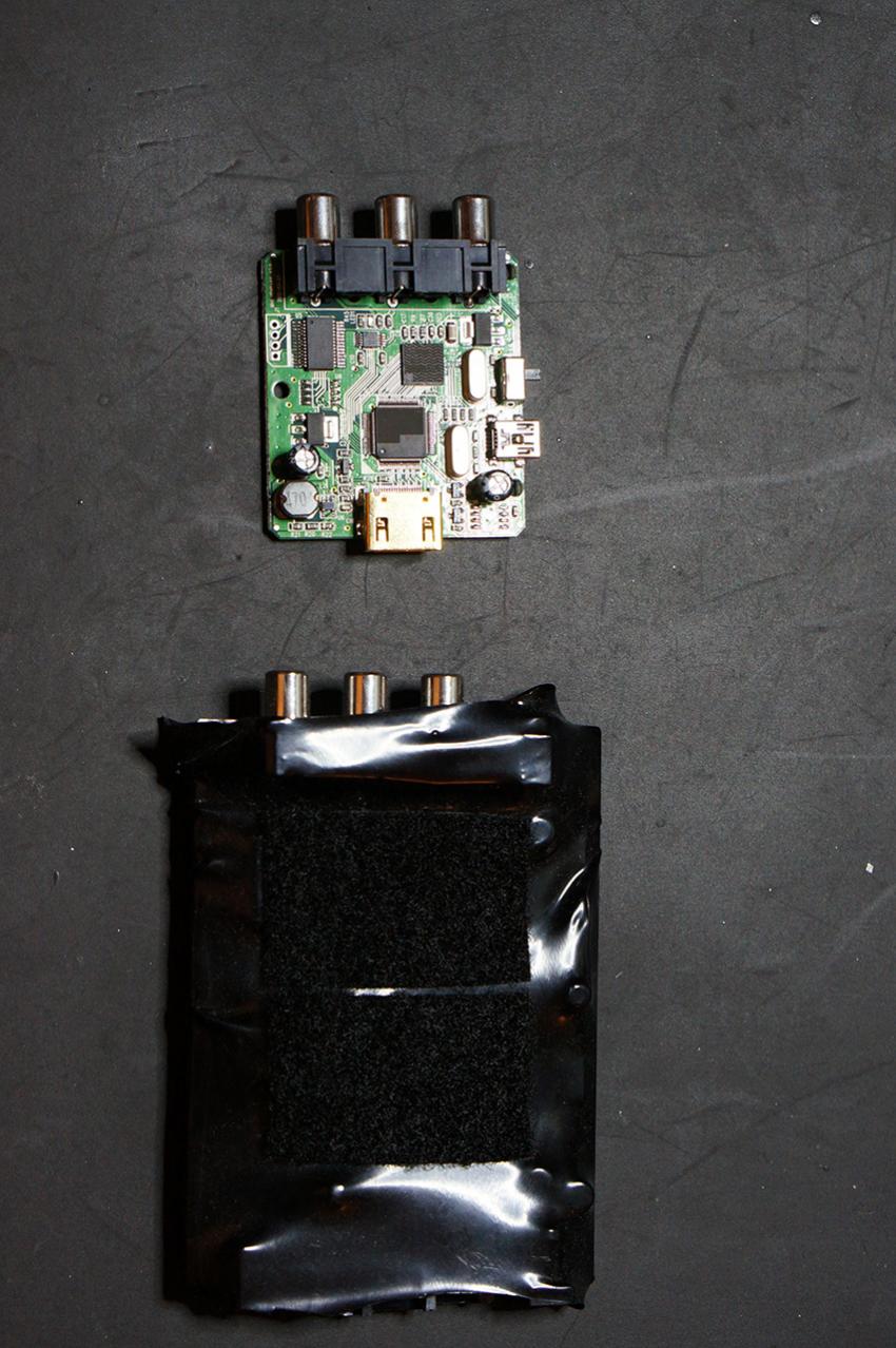

You need THIS ONE. I've been telling everyone for the past two weeks. I have two of them . AT $37.99 apiece (inc. shipping) they are much cheaper, they are a quarter of the size and weigh just 39g - even with the plastic case.

Here is a pic of it with the case off and next to the old larger version.

The only necessary mod to the GoodLuckBuy mini-HDMI converter is for the power supply. It comes with a small USB socket. I opened the case and hard wired a regular three-core radio cable to supply 5v +ve and -ve and feed the +ve video signal (power and video share the same -ve).
As the circuit board pins of the USB socket are almost impossible to see, let alone wade in with a big fat 1mm solder-iron tip, I soldered the +ve wire to the nearest parallel point which is +ve leg of the smoothing capacitor just to the left. The -ve goes to any earth tab - I use the metal surround of the switch next door - and the video cable goes to the centre pin of the yellow phono socket. I removed the three phono sockets anyway.
With this three-core radio cable arrangement I am able to utilise the dedicated camera socket of the Iftron transmitter without any further connections or wires being necessary.
