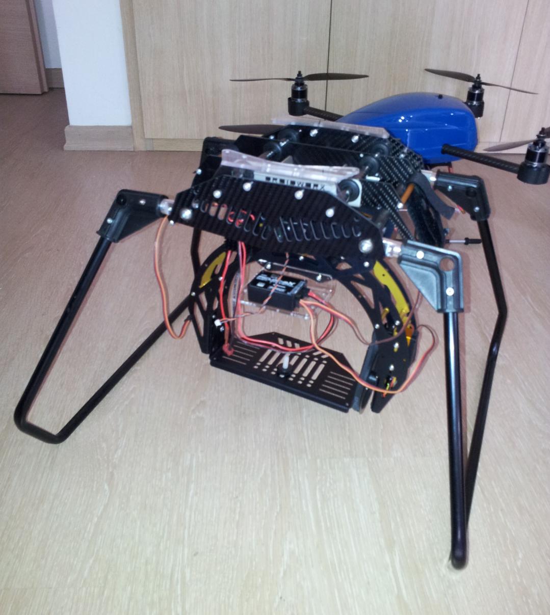

Skyjib x6 flying RED Scarlet
Very nice!
One question. Don't you find the much lower center of gravity affecting your flight performance?
If the adaptor used to connect the CS360 was facing the other way like a conventional Skyjib the frame would have been much closer to the gimbal.
Lanzar
There is no other way since u cant pan on the skyjib 8. It is hitting the lifting legs. We did all the options on how to adapt the cs 360 to the skyjib.
