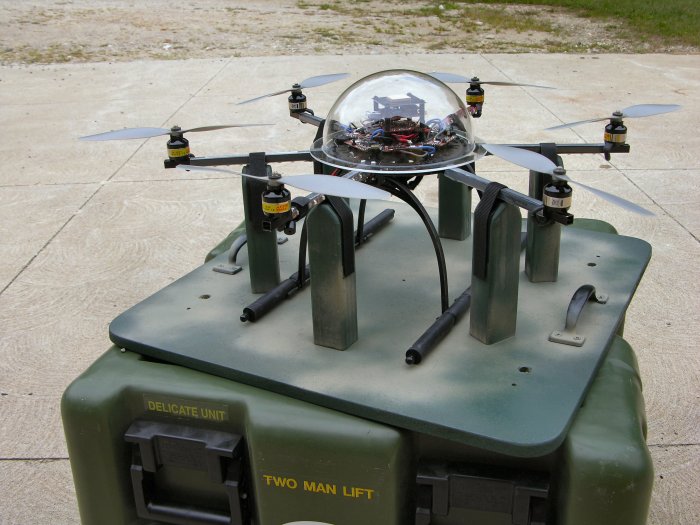

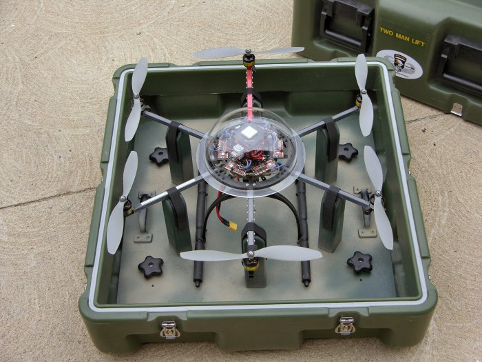

Go to eBay and look for Hardigg Military cases. The military throws these cases out of airplanes so they are sturdy.

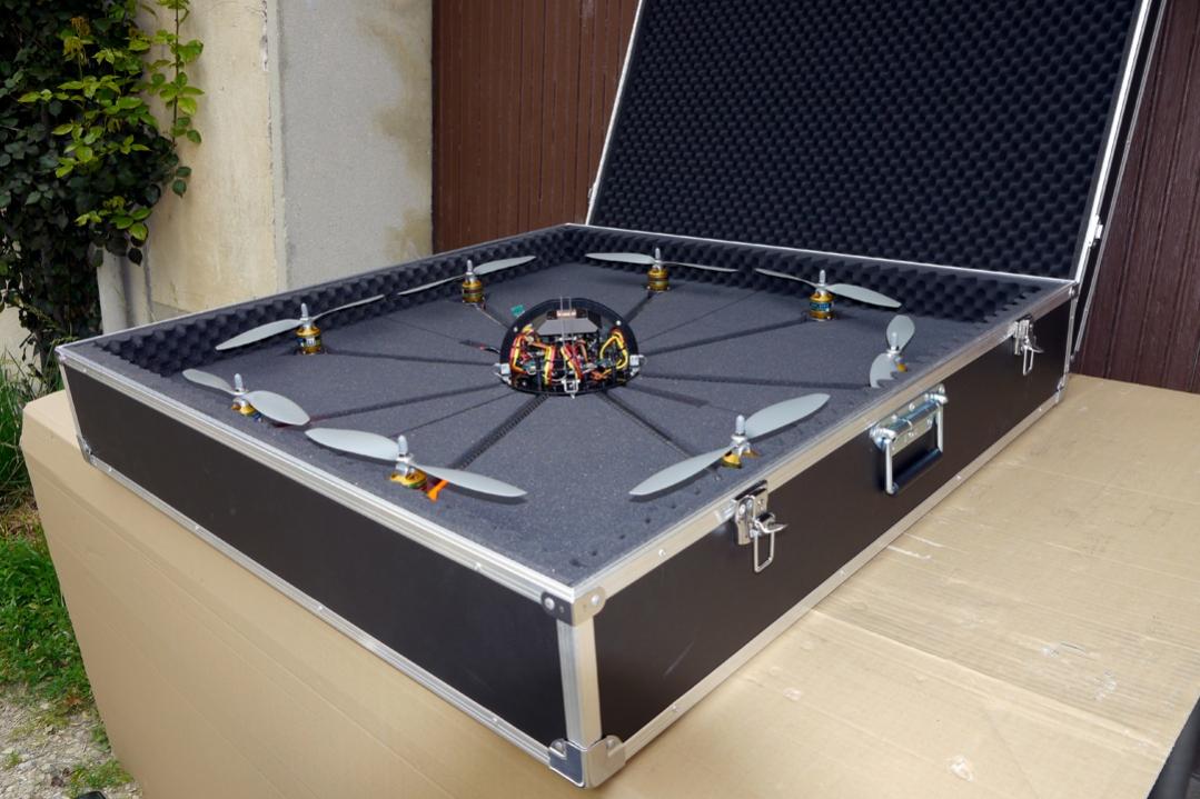

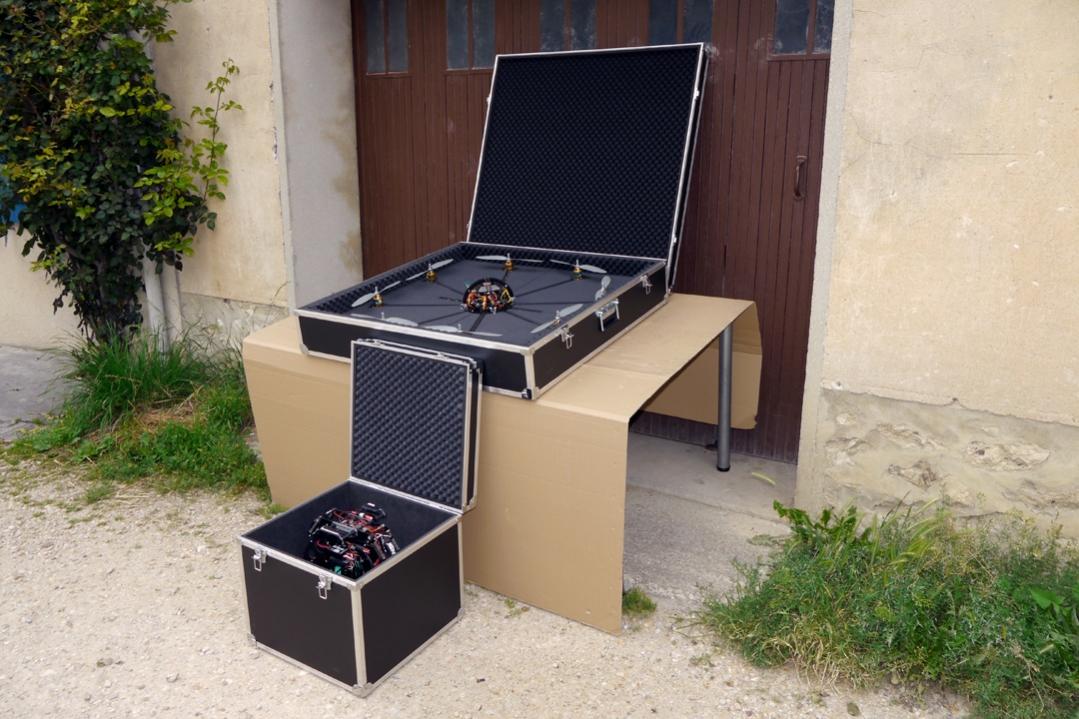

There is some possible overseas work coming up and this means getting transport cases organised. With MR's being such ungainly shapes there are very few off-the-shelf solutions. All-in-one road cases are available but they are made with regular music gear road case materials and will weigh a ton.
So I decided to make my own using as lightweight materials as possible, hopefully without compromising their primary purpose i.e. protection. I wanted to avoid the unmanageable dimensions of an all-in-one case and I don't want to have to do a full dismantle and rebuild every time with booms being removed, or even loosened off and swung in line, because quite apart from the sheer aggravation, things will start to wear and get loose. So I have decided to live with a partial dismantle with the AD-8 split into two: airframe and skids/mount.
The airframe case is still pretty large, being just shy of a metre square, but with the reduced depth it is at least manageable.

That's fantastic. Are the plywood or? Where did you get the aluminum strip?
FWIW, you can use a good quality truck bed liner on plywood to create a really tough, and fairly professional looking surface. You certainly can't see that it's just plywood.

Other than the primary objective to have a case to transport and protect the gear the main aim was to keep them as light as possible. It is not plywood. It is a plastic sandwich - much like the corrugated cardboard of a regular cardboard box only in plastic. It is 40% lighter than the equivalent thickness (4.5mm) of ply and much easier to work with.
It probably won't stand up to really serious abuse but with the lids on they are stiff and strong.
All the materials came from an outfit in Germany that supplies all sorts of mainly music related gear, Adam Hall
