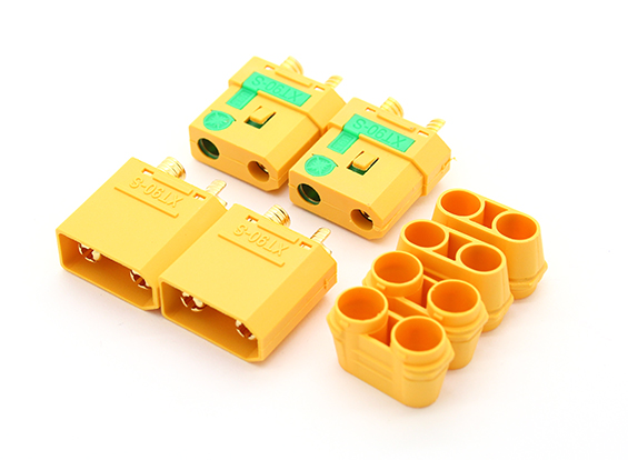

The S900 pulls 135 amps at full power. The XT60 is rated at 60amps. The XT90 would be a better choice and now you can get the sparkless XT90's.
CG Photo
