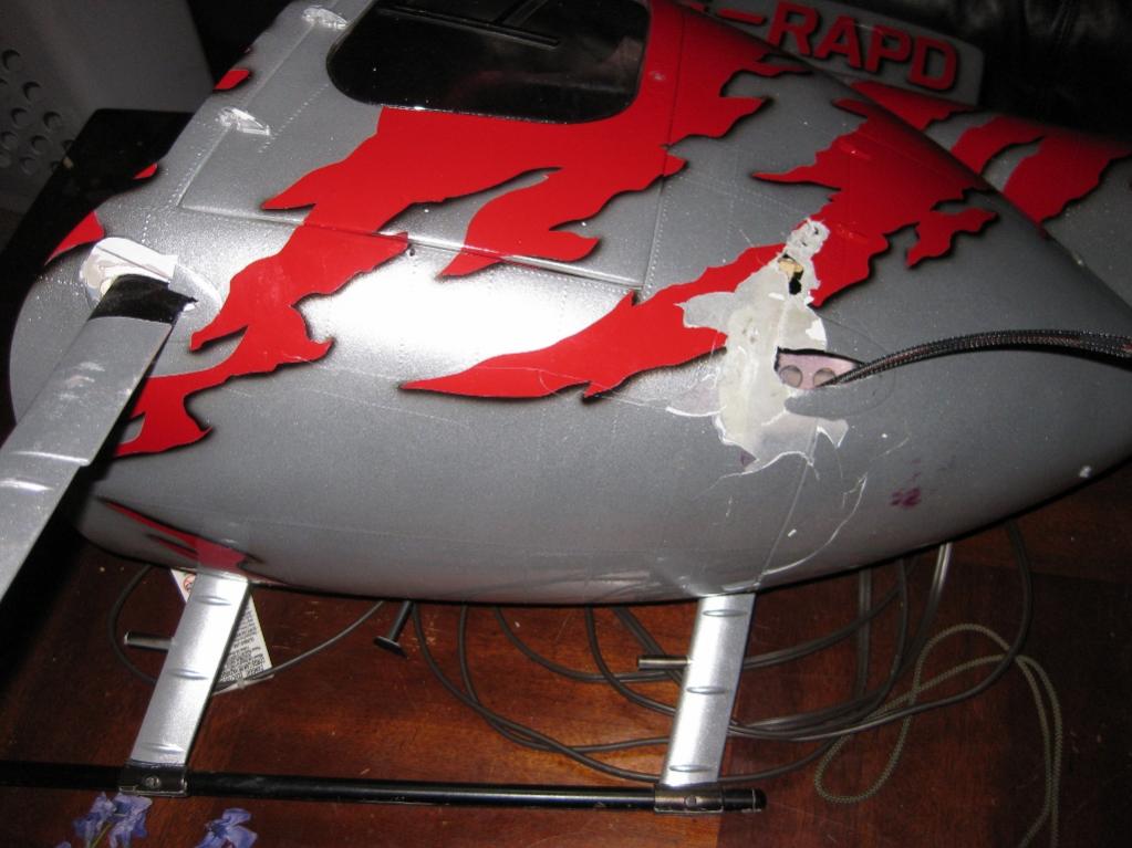

Over the last 4 years i've thrown litteraly thousands of dollars down the drain mixing a charged and not charged pack..... the last time it was my 700 size md 500, took off, felt kinda heavy, got a couple laps in, about 300 yards out she got really heavy and the ground was coming up iminent. I dropped the collective but by the time i seen it move down it was too late. i flared and gave it full collective. Luckily when it hit it smashed down to the floor and kept level without blade striking the ground, but it litteraly destroyed a $4,000 model in the blink of an eye. I had been hagling with a guy that had me down to $3600 the week before,,,, shoulda sold it

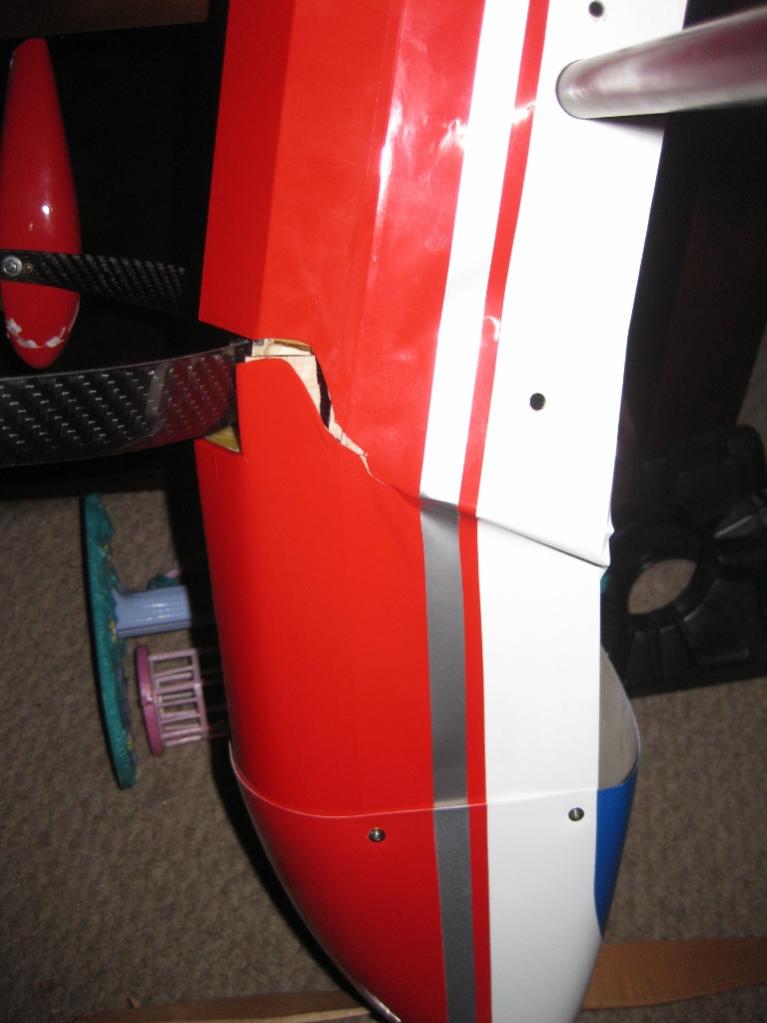

worse rc day of my life..... right after i did that i was so flustered and made the mistake of keeping on flying. Grabbed a 60" electric Extreme Flight plane, was nose diving at the ground and flaring up to a rolling circuit as low as i could,,,, bout the third one in i pushed the stick wrong and blew that thing in half. that was the last time i went to my ama club......
