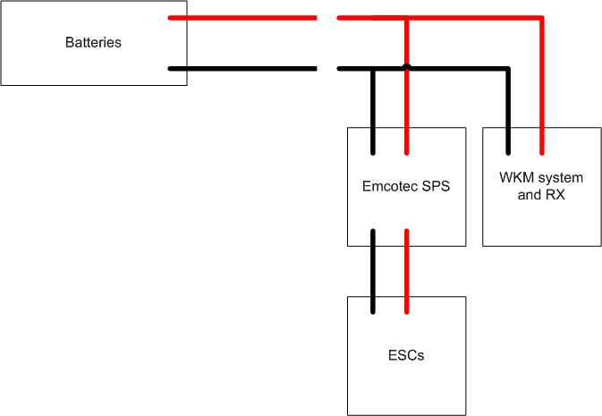

Carapau
Could you not simply wire things this way? This would mean that when you plug the main batteries in, the WKM would power up immediately (via its BEC) as would the RX. Then all it would take is for you to flick your remote switch and the emcotec would then allow power to flow to the ESCsView attachment 9534
