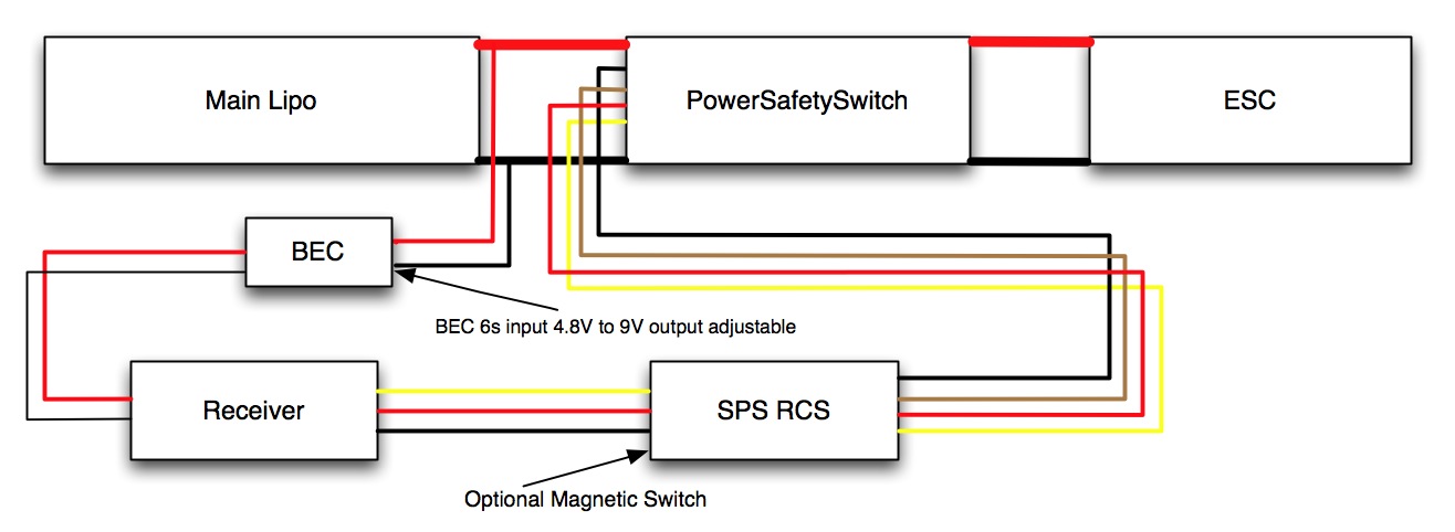

Actually what i am getting at is if your RX can work with 4.8 v for example like the futaba SB series than a CC pro bec could do the job:
Input 5v to 25.2vVoltage: (2S to 6S LiPo)
Default setting: 5.1 volts. User selectable in 1/10th volt incrementsbetween 4.8 and 9 volts.
BorisS
Think thats the way it could be done with a BEC.
Bec in this case could be a CC BEC
And thats the way it would be cool if they would have thought about it. Although they don't really indicate where the RX is powered from

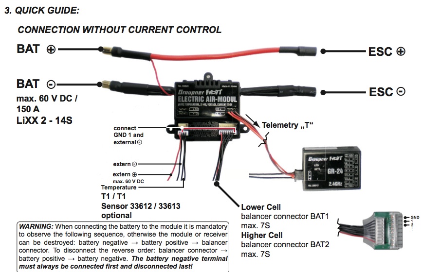

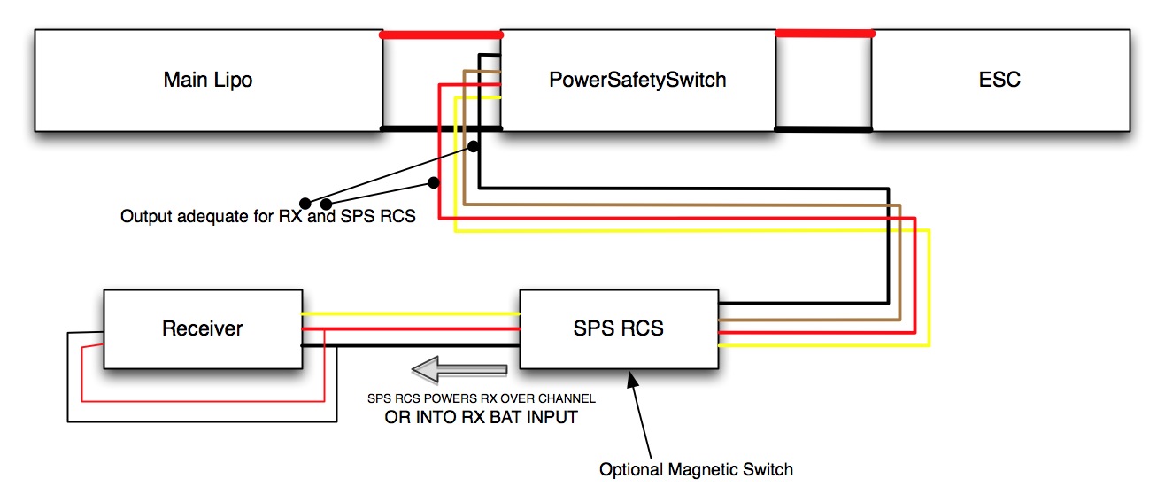

Most of the telemetry Voltage and Current sensors are able to power the main logging unit and the rest of the sensors, so why didn't they think of their power switch being able of powering the Switch remote and the RX, or maybe it does !

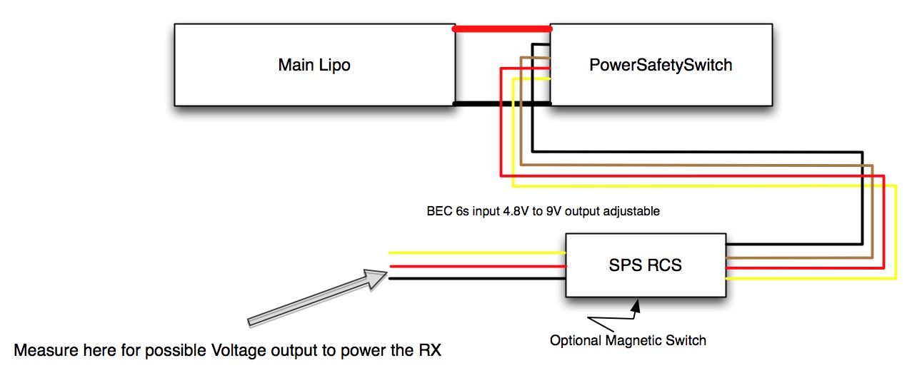

First thing i would do is to hook the power switch and the power remote thingi together and hook it up to a lipo. Take a multimeter and measure if there is a voltage output that could power the RC : Here like in the diagram.
If there is not than the BEC solution would be the next attempt. In this case though it would be good to check continuity on the GND that goes into the Power Switch from the main Lipo and the GND the leave the Power Swicht to the Remote Thinigi just to go sure one if not creating a GND look, but I am pretty sure it won't be the case.
They could have shown more to this product more descriptions !

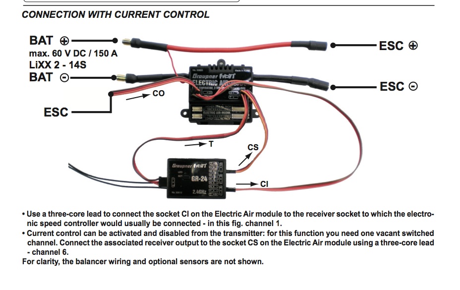

BorisS

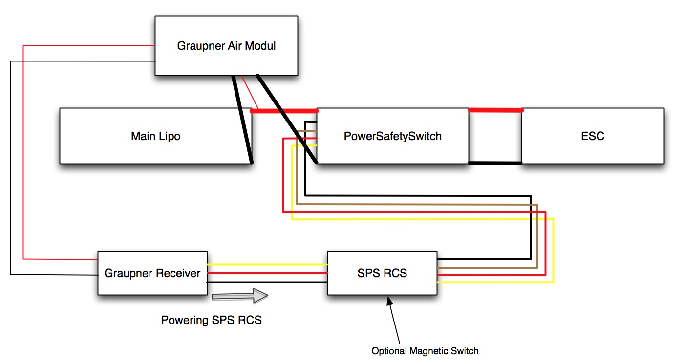

Thanks alot for those diagrams. Ive found one from a NZ hobbyshop so I should have it in a few days to test which way works. Il have a Graupner telemetry unit, which i assume i would wire in after the switches. Is that what your meaning. Run the rx off a bec and then run the ys-x6 off of the tele unit? http://www.kopterworx.com/Hott/Air-Module-2-14S-HoTT

Which is really stupid. ( Sorry don't want to rag on it ) but its on the main lipo, it should have an internal voltage regulator and power itself. Smaller device like this one power themselves and the unit that come after it :
and than on it powers the main logging unit
BorisS
Ah okay and than thats also the setup wait now i know what you have to do ! Ill draw it up.
BorisS
Okay Graupner Current sensor powers RX RX power remote for Switch and Switch itself:
Nothing else need no BEC or RX Lipo.
But this only in the case if the Safety Switch doesnt power the Remote switch already and then the remote thing and the RX. If that the case than you see sparks if you hook it up like above. So the most important thing stays.
Do this first " First thing i would do is to hook the power switch and the power remote thingi together and hook it up to a lipo. Take a multimeter and measure if there is a voltage output that could power the RX"
Than it has to be hooked up in a different way. But once more I don't think you will need a LIPO or extra bec to power the RX either the graupner oder the safety switch components will take care of it !
