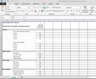

Hey, I've seen something like that on the interwebs! I never got to build one, I just threw a battery in mine and started crashing. But what is the fun in that right?
One thing I've done for working out my KK adjustments was create a excel worksheet with all the menu options down the left side, and the baseline settings I was starting out at. I the made small columns with room to write at the top (as far as what he adjustments did for me). Then each time I made a change I'd write in that column alone and what the results were on the very top. The other VERY IMPORTAT aspect was I only changed one menu aspect per time so I knew what I was actually getting.
Now, once I get my stinking ESC issue worked out (I have one that keeps quitting/flashing red - AFRO 20a w/SimonK) I'll get back to it!

Welcome back from the "field" Corey. I used a "spread sheet" too- scrawled on the back of a piece of scrap of paper with the intentions of putting it on excel, but I lost the scrap of paper; maybe it was toilet paper? I forget. Anyways I am glad you are back and safe.

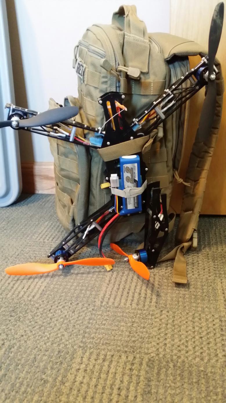

The lesson for today:
When you THINK you are ready to give aerobatics a try...
You aren't....

Motopreserve
Oh no! Corey, that thing came flying back your way pretty damn fast. Be careful!!!!
What type of props are you running? They look like the cheap ABS type. You might want to think about an upgrade. Been reading reports about them coming apart mid-flight.

Scott- I have been reading reports and seeing visual evidence of Honey Badger arms breaking on hard ground impact and/or less than effective interactions with solid objects.

The Honey Badger definitely seemed like a fairly solid design - but then again, flying into the ground will put any design throuh it's paces! :)

I had the pieces replaced in about 30 minutes but when I gave it a quick indoors test-run the motor on that arm wasn't really "happy". I'm not sure if its ESC or Motor. I've got replacements in either case, but I opted to put it aside and start working on my FPV equipment. I've had it for about a month and hadn't got around to putting it together (mostly because the APO/AP mail system decided after 7 months my address was "undeliverable" and sent the monitors back to Amazon...) So, re-ordered those and decided to wire it up to give it a test run.
Now if I have Monday off (not sure yet) I'll take the Honey Badger apart and replace the ESC / Motor. I just ordered the rest of the arm available through RMRC (3 more sets). I've already broke 2 arms, I've only got one (currently) in reserve. 2 Motors and 2 speed controllers...
I love having spares on hand!
I nearly had the flip but throttled it back into myself. I don't think I had it balanced quite right. It felt a little aft-heavy and that is the way it accelerated.
As far as getting the settings worked out, I'm getting there. I got bored with tuning and figure I'd go straight to smashing today.
