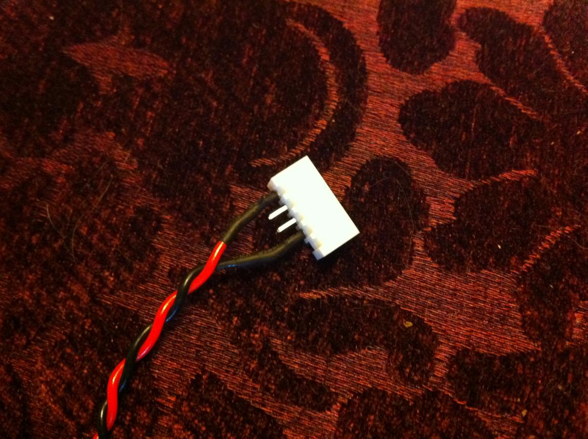

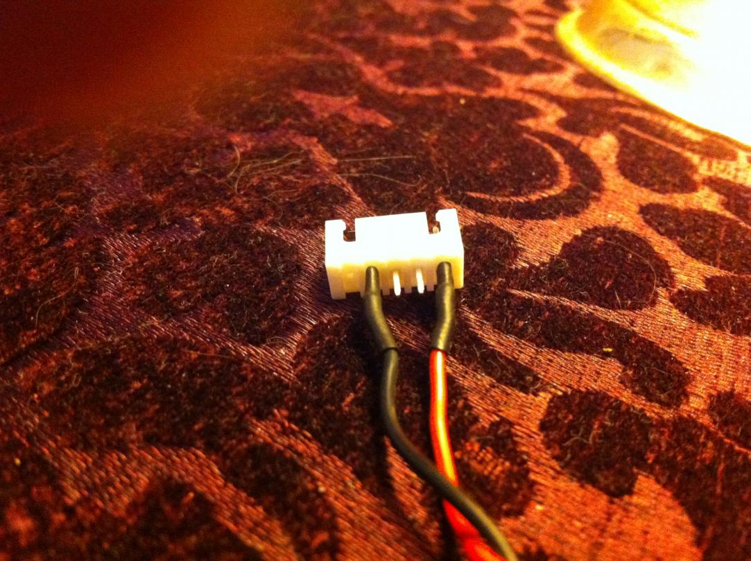

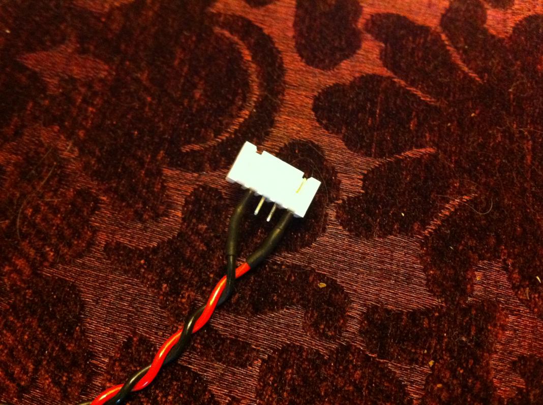

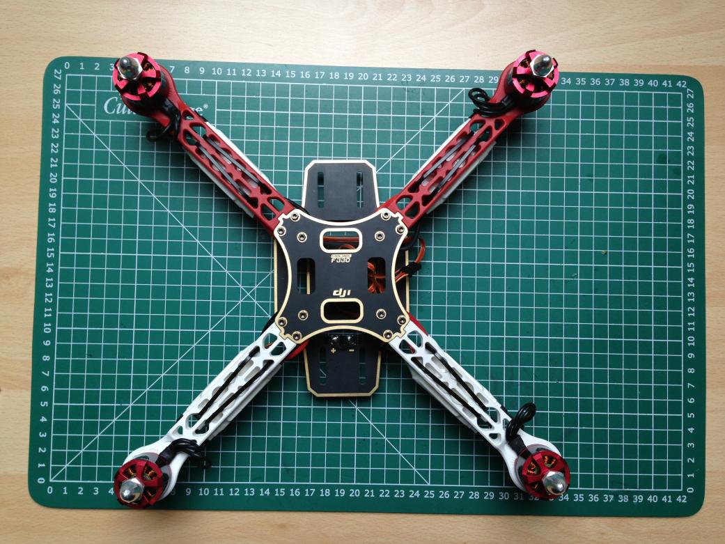

My immersionrc VTX came with a lead just like you described. Just accesses three cells. I use an EZOSD which has a separate output for the VTX so you can dispense with the balance plug lead when using 4S.
I just wire them right to the power distribution board right next to en esc or power lead, can also go straight to an esc power pad line on a flamewheel frame. 4s goes straight into that little red and black plug. the red coming out of the 4 pin plug is 5 volts for a camera or hdmi converter.
