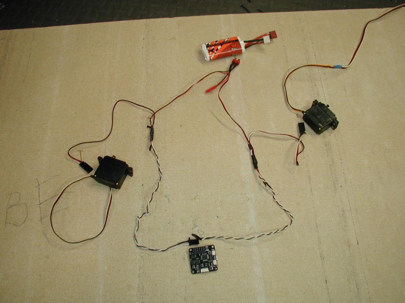

Roberto,
You are correct in that the white signal wire goes to the FC but there must also be a black ground wire common to the servo, FC, and power supply for the signal wire to work correctly.
the photo is my first attempt at a wiring harness for my camera mount. it's changed a bit since the picture was taken but the basics of it are the same.
