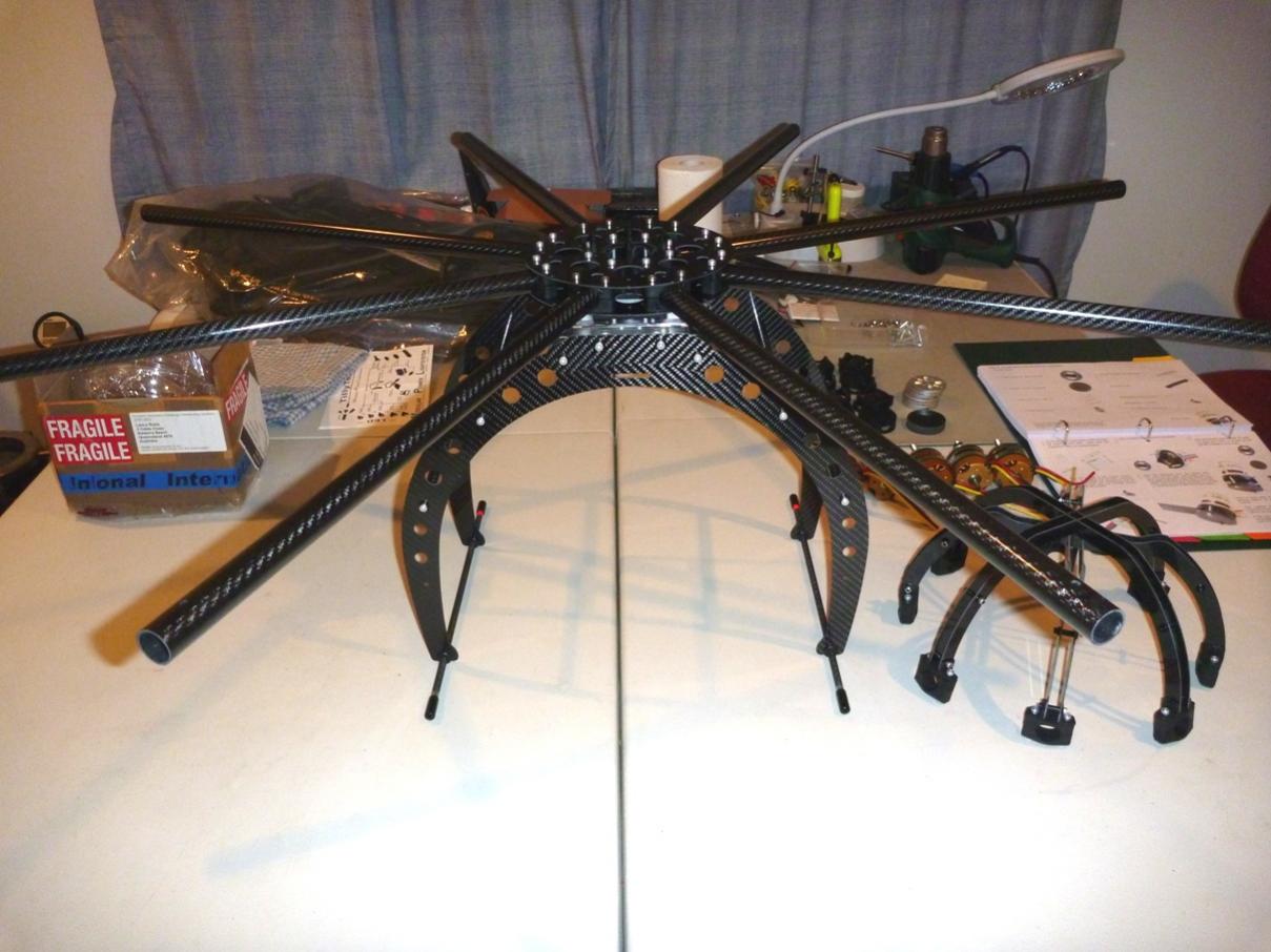

I screwed the airframe together in only a couple of hours so I started with the motors and fitted up the prop adapters to the 5 motors which arrived yesterday (the other 3 are coming from a different supplier) Then I got pulled up when I found I have to cut the shafts and it was too late to go making lots of noise ;)

Looking good mate. As for the motors...yep its a royal pain in the A**E, I ended up sawing 10 shafts...naffed 2 motors in the process (grub screw sheared).
Good luck with the sawing...its toughened steel ;)

Thanks Ross, Yeah I bet it would be if you were sawing them!!! I have a small grinder fitted with a 1mm thick cut off wheel.......Each shaft took approx 30 secs to cut off and dress.
