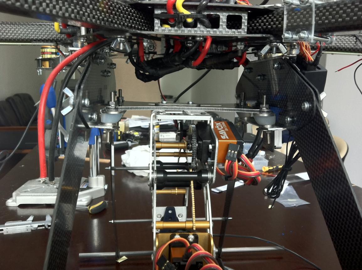

View attachment 939View attachment 938

Weeks since i could fly and test the last changes i did to the AV 200, but i also got the 130 AV now on my DJI HEXA (didt really see any other options) think i went a little overboard with the silicon. Certainly isolated from the vibrations now if any get to it. But at the same time the whole thing got pretty wobbly. Lets see how it performs. :) Picloc is also on its way and i am going to test the DJI stabilization.
I have the same landing gear setup with the GoPro mount Coptersky sells as well. From the one or two test flights I did with it it seems that the mounting system is a bit too soft as there is a fair amount of camera sway visible in the video recordings. Once I get the WKM Y6 dialed in I plan to put this setup under it to see how well it does or doesn't work and also try it with the Avertical View 2 axis mount I had under my AD6.
I think the trick is to get just the right stiffness of the isolation mounts to match the weight they're supporting and that will take a handful of isolation bushings with different ratings plus a bunch of spare time. Another thing that may help is to use an RC car shock absorber to steady the mount a bit more in the horizontal plane where most of the mounting sway occurs, I have plenty of those to choose from around here and may give it go if I can't elimiate the sway by any other method.
Here's the Y6 when I did a test fit with the Coptersky gear...
