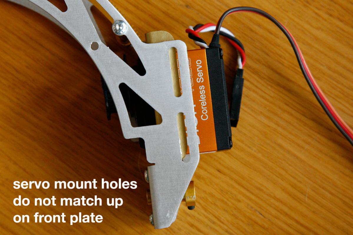

Wonder if anyone can help with this one.

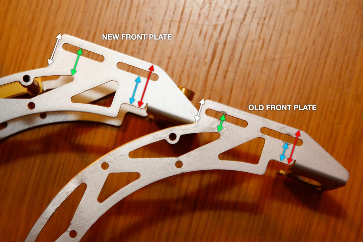

I totalled my AV130 roll cage and bought new front, rear and roll gear plates.
I reassembled the unit last night and seem to have discovered and issue.

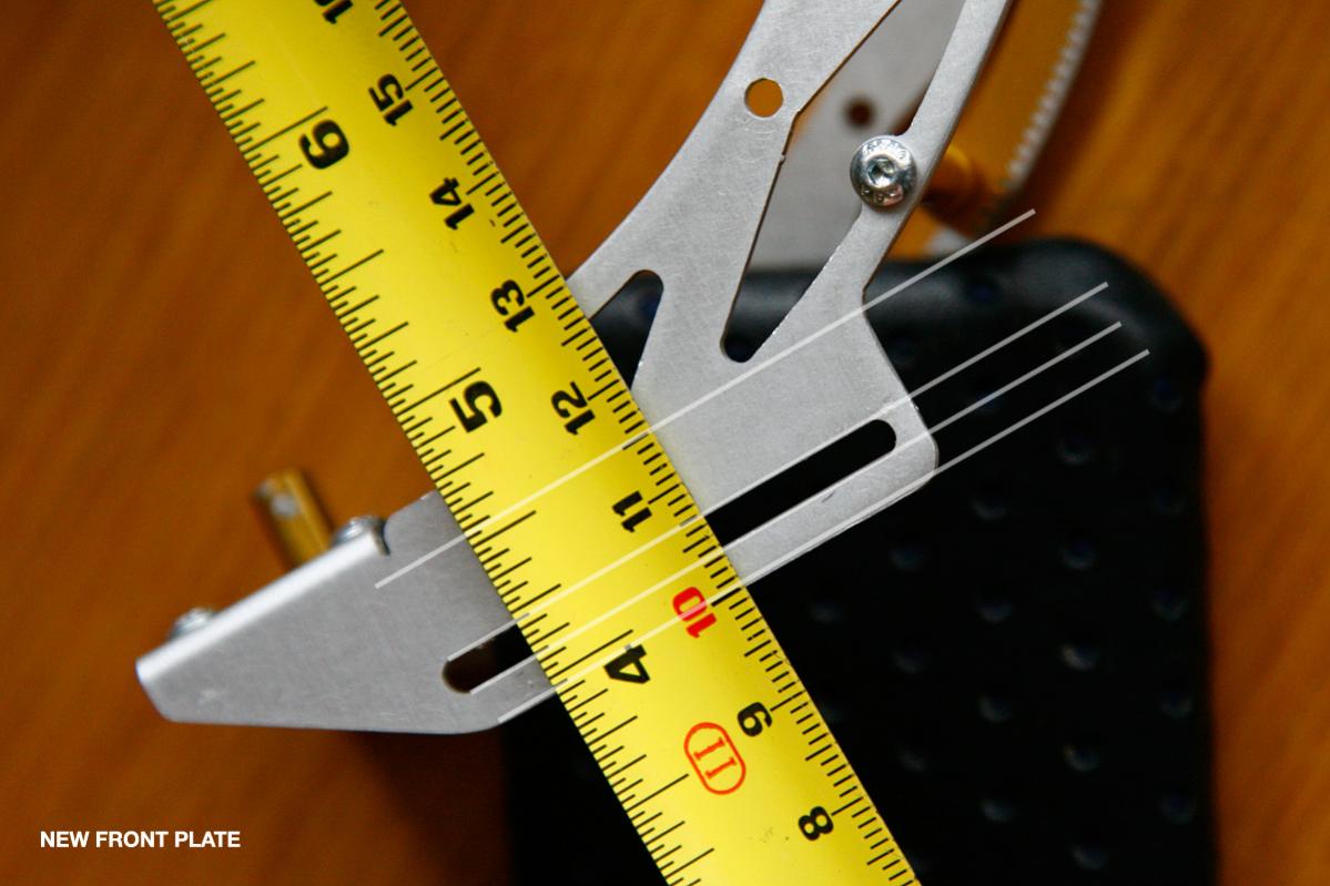

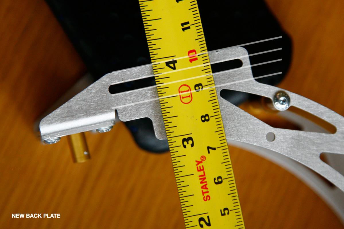

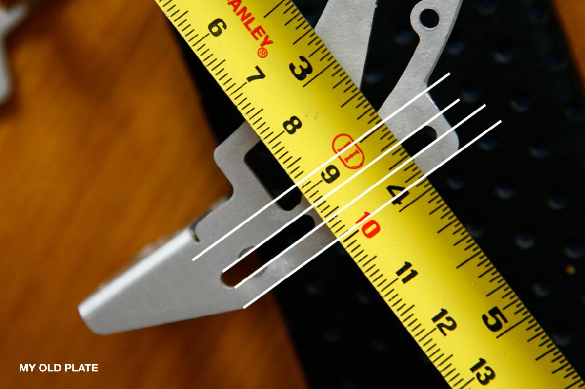

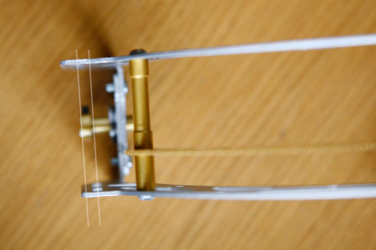

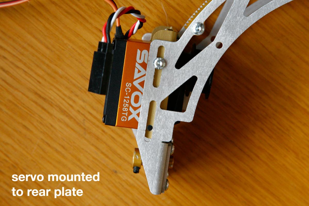

The slotted flange, for the tilt servo plate, on the new front roll cage plate is longer and the slots are in a different position.
I've tried to assemble it a number of different ways and the only way where the bolts align for the roll gear plate, leaves the tilt servo plate out of alignment.
In the pictures below the one with coloured arrows shows my old roll plate and the new replacement plate and it's obvious that the flange on the new plate is larger.
Could anyone who has also encountered this issue let me know (so i know i'm not going mad), as i'm having issues getting it resolved.

Aye Up,Dave
Summats not right there.. Have u sent the pics to PH?
I have replaced mine in the past with no mither.
I dont thin u are going mad!
dave
