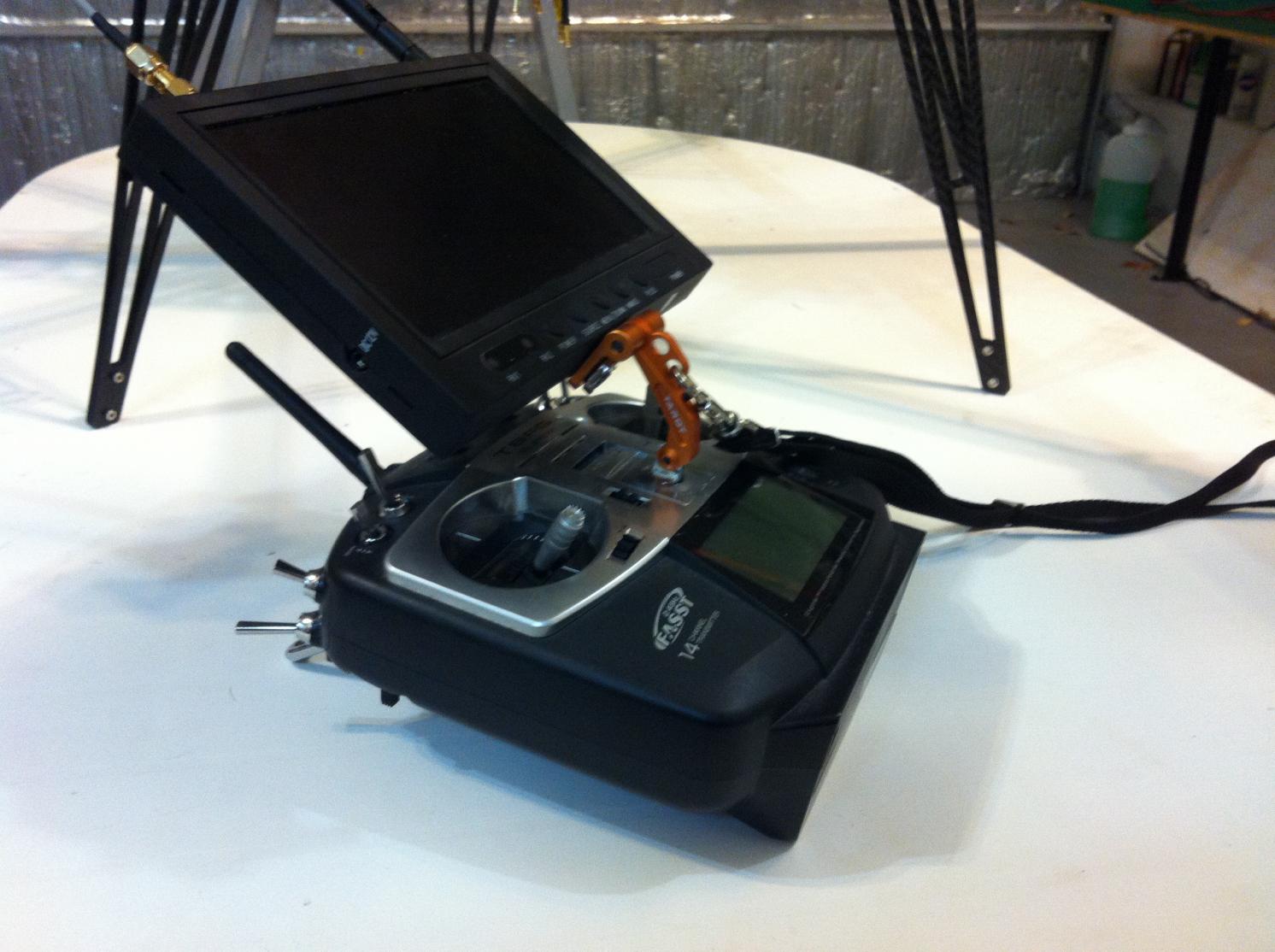

Thanks for the tips. Unfortunately (or fortunately!) I already pulled the trigger on the 14SGH. It was not on my radar until I started doing more research into Futaba products. And then it seemed to jump off the page at me! :)
