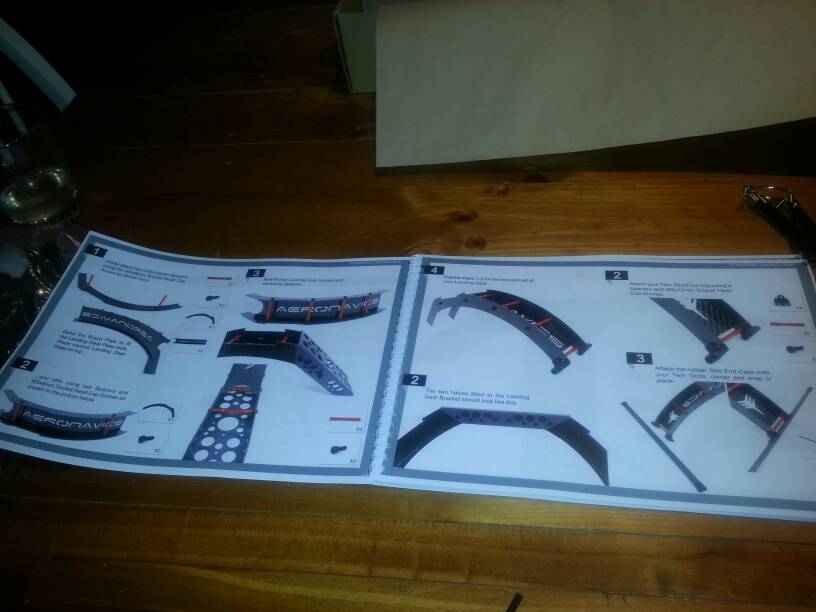

nicwilke
Instructions downloaded, printed on digital press, wire bound.

nicwilke

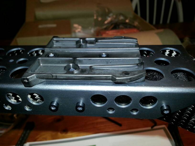

Landing gear assembly. This is way cool. Little tricky to put the thin ply carbon fibre sheet in, but it looks so good with the anodised aluminium orange.

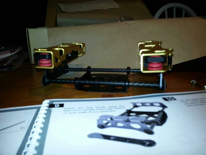

nicwilke

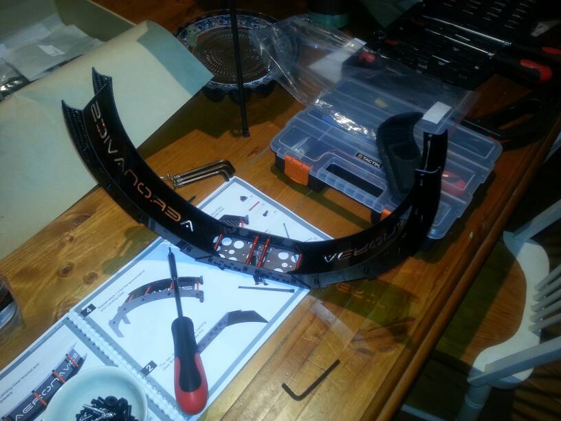

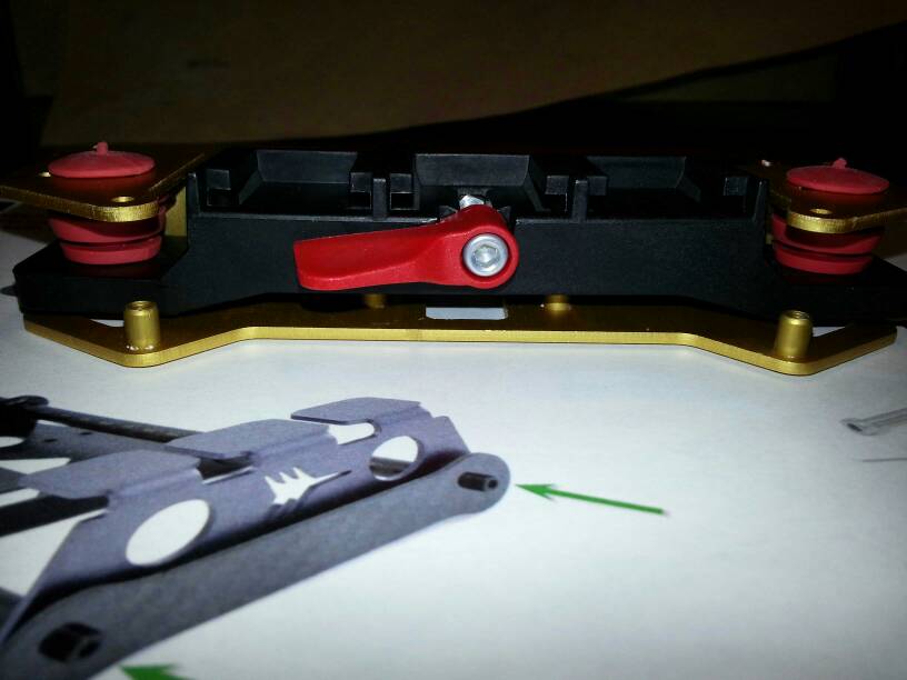

Gear rail assembly. Vibration dampener is really well designed. I suggest you rotate the rubber dampener while inserting into the alloy gear brackets. Makes it easier. You have a choice of 2, yellow (soft) or red (firm). I'm using firm.

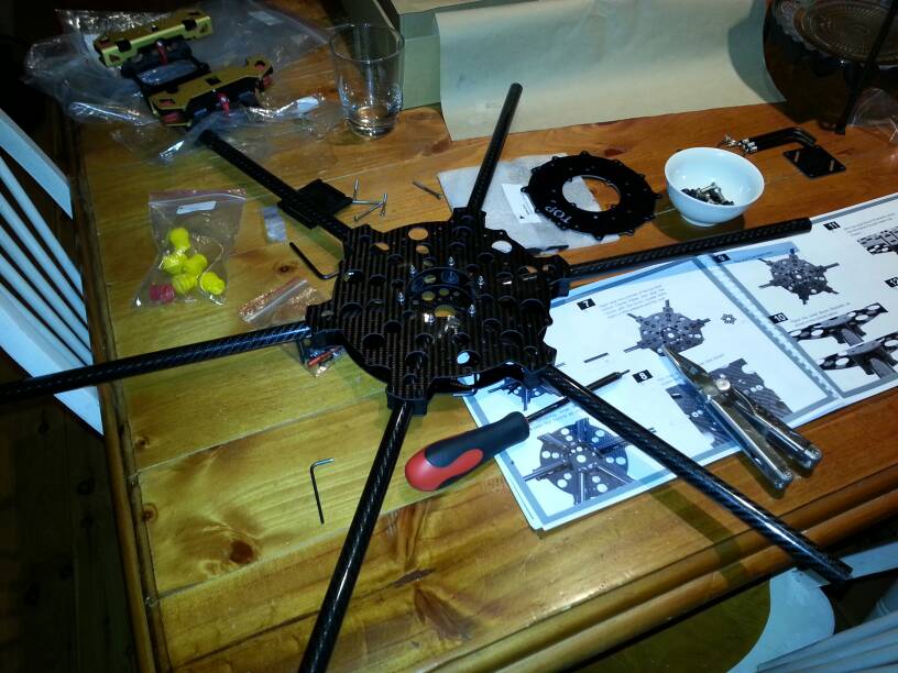

It's nearly 1am, so turning it in as I think I break from the manual to do the PDB. Too tired to check.
Taking shape.

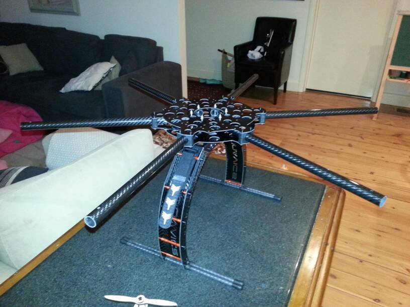

nicwilke
Really do not want to stop, but need to be alert tomorrow. See you all in 18 hours (7pm AEDST)
Aah, really nice Nic! Love that Quick release. As far i remember they will not retrofit to the AD6? Am i wrong or Linda told us here, that they will offer the quick release also for the AD Series?
Have fun with it,
meme
nicwilke
There's 2 quick releases, gimbal and land gear. It's incredibly well designed. Not dissimilar to the ADX, but the new stuff is really cool.

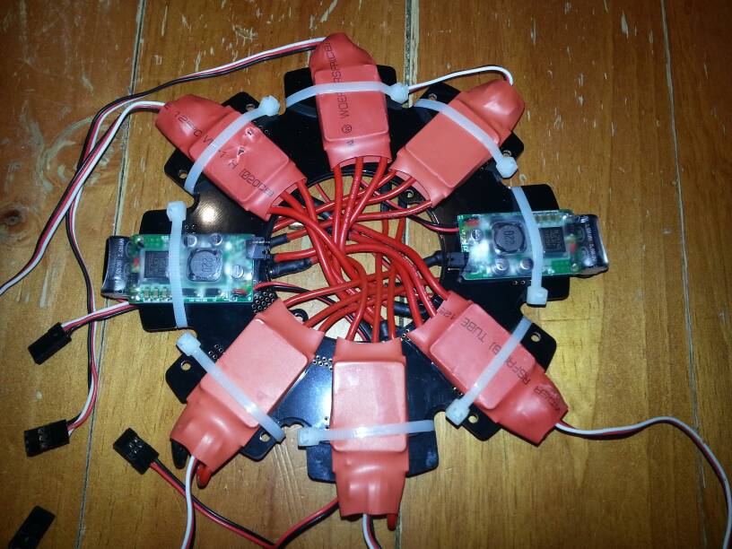

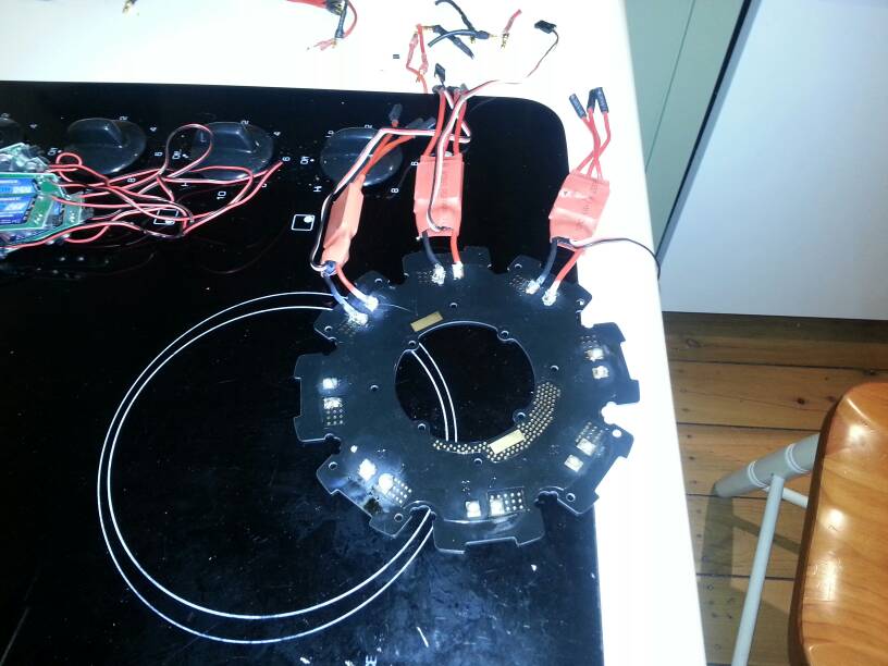

nicwilke
The Droidworx PDB is capable of 8 ESCs, or in this case, 2x 6volt BEC's. One for the Rx, and one for the gimbal.
