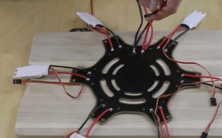

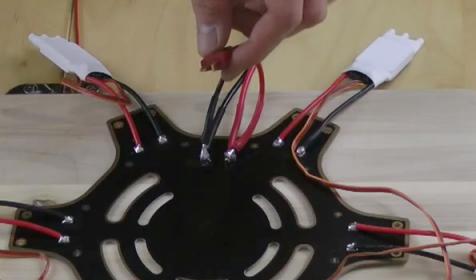

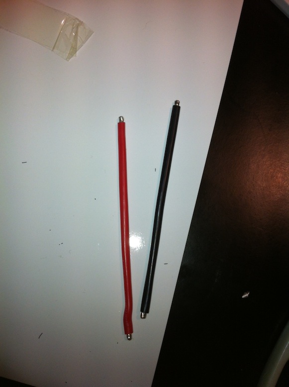

In the last video you posted the man talks in 12:55 about two pair of wires to connect to the battery, but I don´t have this wires and connectors , It didn´t come with my F550 and WKM kits. I only have 2 wires without connectors like these:
The man talks about a a 4mm bullet connexions for these cables:
and another kind of connexion that I can´t reach to understand (I´m spanish):

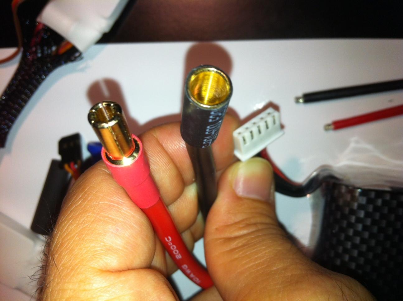

My batteries have the follow connectors that I think could be the first one 4mm bullet type compatible and another multipin white connector:

Unfortunately, when you get your RTF kit, you're still little ways from being ready to fly. There's all kinds of little things you need. As far as your batteries, they come with different kinds of connectors and you need to decide what one kind you want for your system.
Then you're probably going to have to solder connectors onto your batteries, get/or make a charging cable with the right connector to hook your battery to your charger and make a cable with the right connector to solder onto the main pads on your copter so you can plug your battery in there
By the way, that small white plug you are holding is the balance plug. It plugs into your charger so the charger can read each cell in the battery and balance them as it charges.
I personally like XT60 connectors but there are a lot of different ones. The XT60 is fairly easy to solder a wide range of wire gauges to, it connects solidly and it's shrouded -- the male and female parts of the plugs are covered so it's a lot harder to accidentally short one out and kablooie goes your battery.

Mike is correct, I received the same two wires showing in your first pic, you need to solder these on and choose which connectors you require. Before doing that also check about connecting the NAZA I ended up soldering the two connectors on as well your pic two. Sounds confusing but it will come all clearer. It can take time it, took me a week of evenings to go through double check what I was doing, and I'm learning all about setups batteries ect. Great people in the forum all helpful and have a vast knowledge.

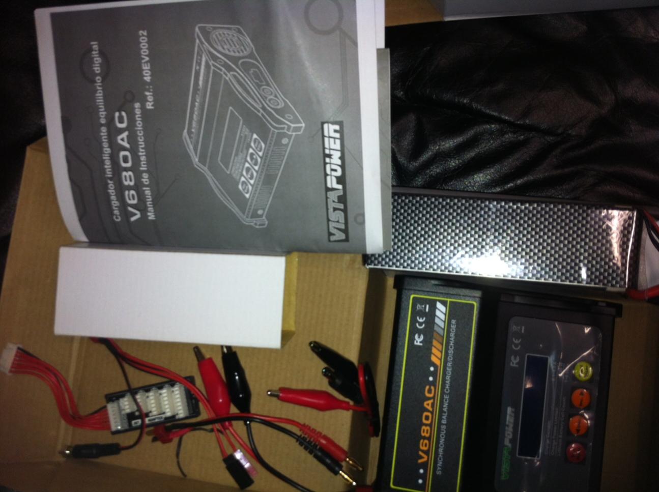

My lippo charger
Off course, I gonna take my time, going step by step , when I have a doubt I ask, when I have the answer I continue.
First step: building the machine point to point , learning all about each component.
2nd step: to power the machine and test, learning about batteries , charging and testing without propellers in the motors.

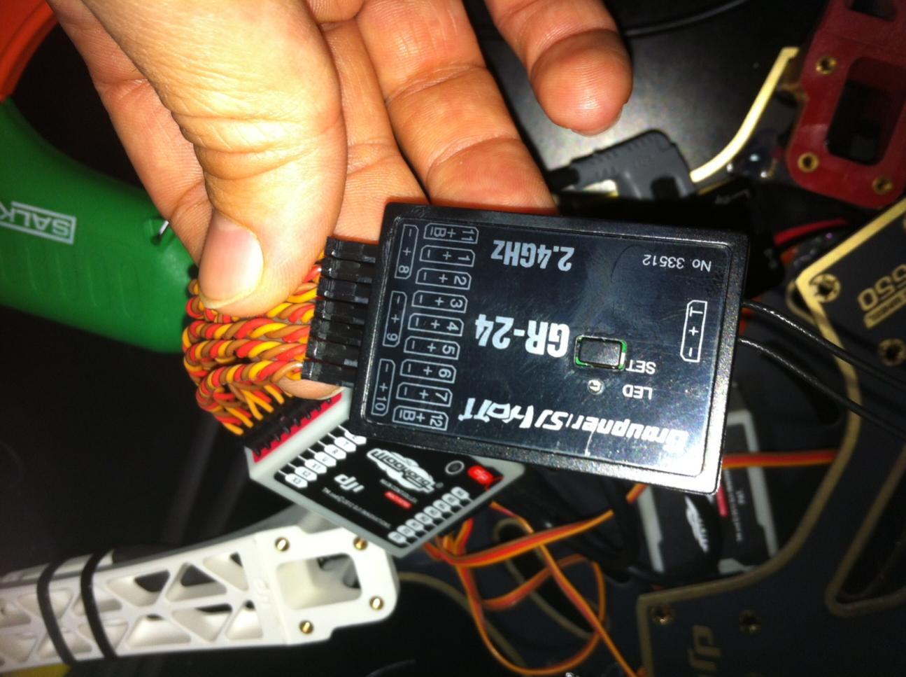

I have a new question about receiver, I have a Graupner SJ Hott GR-24 2,4Ghz receiver for my Graupner MX20-hott transmiter-controller. I have read in the manual thats the receiver get the power from any servo port but I don´t know I f do I have to plug an additional battery to any port or if the MC Dji MKV gives the power through it´s connections. Could you solve my doubt, please?
This is my receiver:
