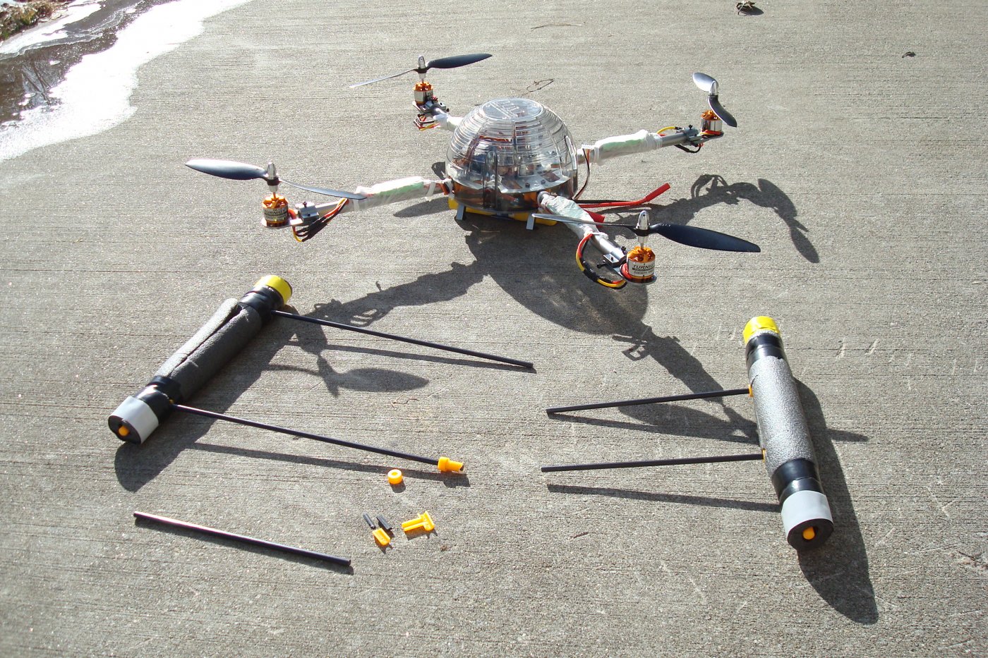

Eric- I'd been flying quadcopters for about a year before I built the "Flying Cuisinart". Much of the support that I received in the building process I received here at this site.
This was the result of my maiden flight. I have had a few more since with a lot of damage. Nowadays I hardly ever crash, but if/when I do they are awesomely spectacular.
It's all part of the learning curve flightpath.

I was lucky i didnt do more damage then i did. It crashed hard every time it crashed. I did have carbon fiber props on so i think that keep them from breaking. So i think i can straighting out the one arm and put my other landing gear on and it should be ready to fly again. The one thing i dont get is when i start to take off it just flys straight up till about 100 feet and would only hover in one spot for 4 sec before it starts to fly straight up again. The only thing i can think of is maybe yhe winf up there
