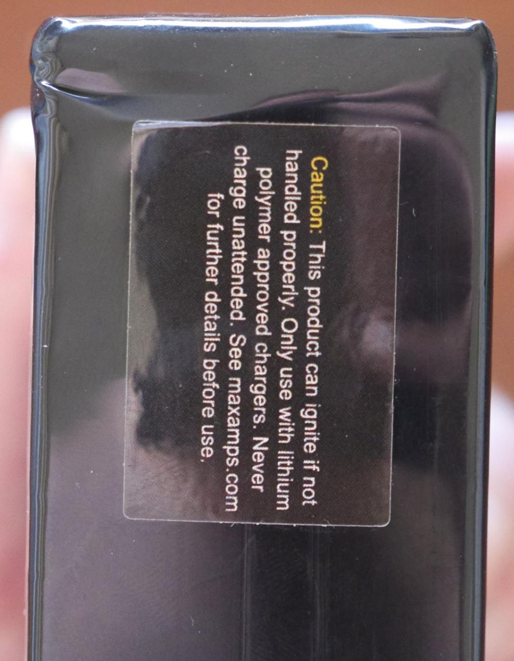

I have a brand new 8000mAH 6S battery pack that I am unsure if the cells are damaged or not after about a 4 ft fall. I haven't even used it yet, I was just testing out the position on my new (still building) SkyJib Super 6 Ti QR and I accidentally lost my grip and dropped the pack on the floor. I would hate to be out $300 just for making a stupid mistake. Is there anyway to check the integrity of the pack and possibly salvage it? Thanks.

cfrea
If the battery starts getting warm immediately take it outside.
Get a voltage checker to check all the cells. Then take it outside and try charging it. It should be fine. Just be careful with that pack though for the rest of its life.

I had it in lipo bag all night and opened it this morning and there wasn't any visible changes. I haven't tried charging it. It has never had a full charge just a storage charge. I have a multimeter, how do you go about checking each individual cell?

Check and see if your charger has a screen that reads all the cells voltage, or use your voltage meter and check through your balance plug. That would truly SUCK if anything happened to it considering it was destined to fly, sorta like Evil Knievel dying on the toilet. Here's hoping!

Most Lipo's have some padding around the corners, I suspect you will be safe. Check the voltages when charging and look for any puffing of the lipo. If it stats to puff then you are our of luck.

Dropped mine numerous times. If the lipo doesn't swell and heat up immediately charge discharge a couples of times supervised and your are good to go.
JoshMaxAmps
You can always contact MaxAmps as well and we would be happy to test out the pack. If it does have any functionality issues let us know. On a brand new pack we can in some cases replace a bad bank. Either way the pros here would be happy to assist you in any way possible. The pictures are inconclusive in regards to functionality. I have seen some in far worse condition that worked perfectly and some that have had similar damage and puff. Likely with that small of a fall you should be fine but as the others have mentioned if you cycle the pack at home be there during the entire process periodically inspecting the pack for heat buildup or swelling. If either occur take it outside. It should not be a fire risk at all unless it sat for a long period swelling on the charger but safety first. Take pictures if this occurs. The Duo charger does have a cycle and cell monitor features. Again give us a call and we will walk you through this process. Toll free 888 654 4450.

Some closure to this thread, MaxAmps contacted me today and stated that they had checked my damaged battery and while it did test okay it did have some visible damage and they recommended replacing the cells. The cost was about $90.00 to replace the damaged cells, not free but then again I damaged the pack. I still have yet to use them and I will report back on whether or not the packs are worth the cost once I get my new SkyJib airborne.
