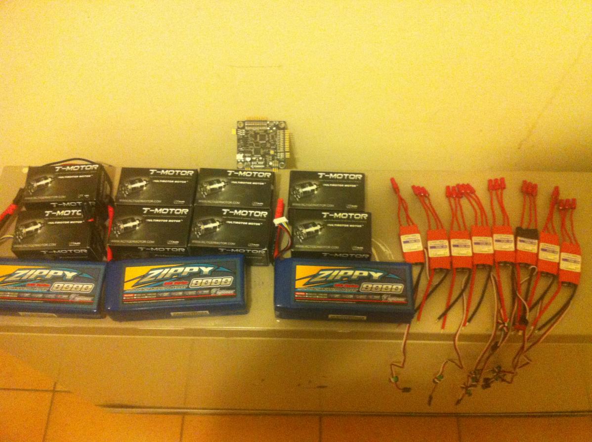

Hello guys i am new to multirotors.. i Had a logo with 3xprov2 and now i have ordered a CS 8 with HFP...!
I have the things above
2x4s 8000mah Zippy
2x5s 8000mah Zippy
8xtiger motors 2814 11 710Kv
8xTurnigy Plush 40A
1x3xprov2 with landing skids and 3xsavox servos 360
1xpicloc 3xpro (i have the latest version its ok i have tested with my heli)
8x 14x7APC props SF
8x 13x6.5APC props
8awg wire
PrC6 connetcors
3.5bullet motor connectors
And of course the CS8...!
Videolink Vrx Vtx lawmate with Bluebeam Antennas..!
As i camera i will put a 550d or a Nex 7
Some things are on its way and some other i have already recieved them..!
What do you think will be the best Combo on lipo vs Props.???
Is there a way to fly with the same settings 5s with 14x7 amd 4s with 14x7??
Thank you
PS ANY comments are Welcome :) :)

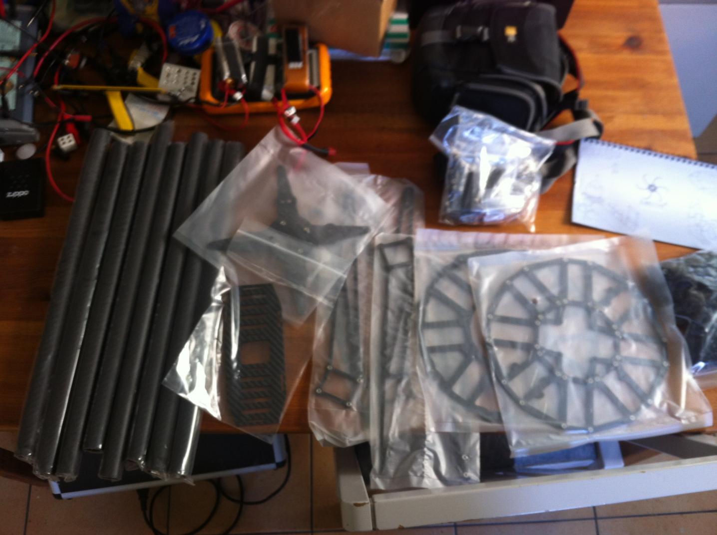

And a photo from the the equipment..

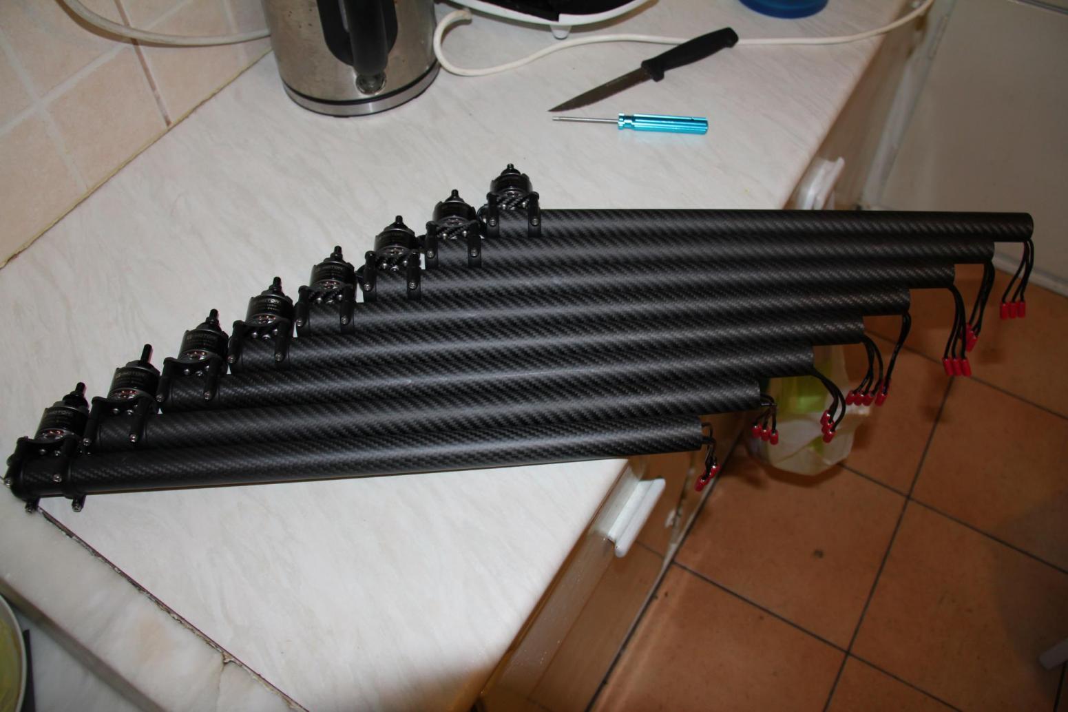

Booms are ready and motors too with the triple motor connectors..! Any comments are welcome..! i am new to multis.. :)
